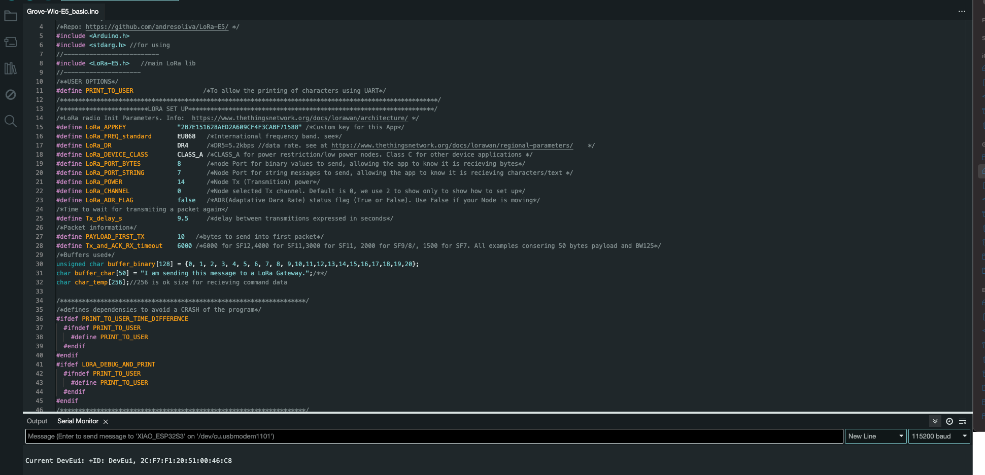

TX interval of 9.5 sec?

@dhyanshyam3, you are transmitting so fast that you are breaking the law as well as breaching the FUP.
Please do not post pictures when the text can be copied & pasted.

Nope, half that as there are two transmit statements in the loop…
And one of those is a large (for LoRaWAN) ascii string…
