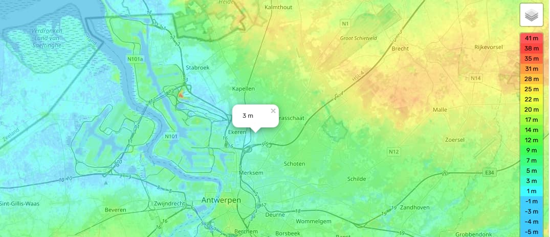

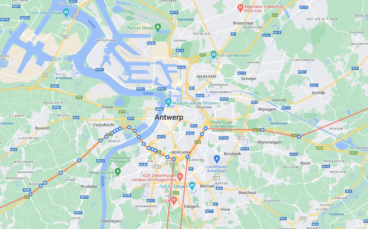

The key point with your 'ish location is, if I recall, very low lying ground north of Merksem, with the area approximately around Hof de Bist and Donk barely 0-3 or 4 m above sea-level. There is a distant GW N.East but likely that will be masked for you by the higher (10-20m higher) ground around Brasschaat. The closer GW’s to south and east in Antwerp proper will almost certainly be masked by the elevated roadways and building clutter in between. The A/E roads are typically elevated (Leugenberg to Antwerp Nord to Kliene Bareel junctions) - as are the rail lines to east and south of you and with shallow angles to your area almost certainly masked. One can get decent signals along these transprt routes - see below for one I grabbed last week. Drop either side however and coverage rapidly fails. Close in to Antwerp on the E17, A12, E313/E34, E19 is good but to the outside of these spokes and ring road its challenged.
Local Topology:

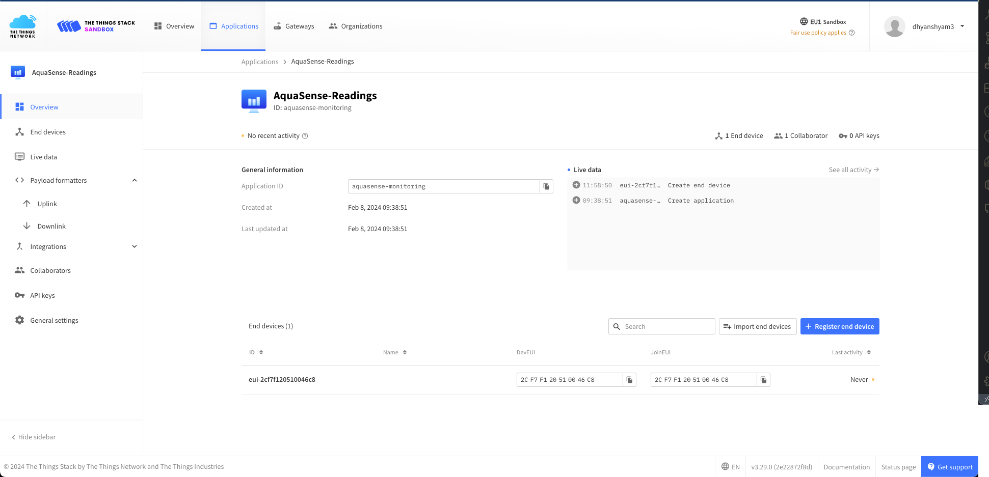

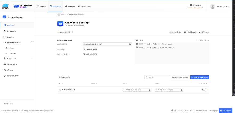

Hi, My name is Dhyan and I am a Robotics Undergraduate student from the University of Plymouth. I am new to LORA and LORAWAN and I recently picked up a Grove - Wio-E5 and I plan to use it with a XIAO ESP32S3 and the XIAO Expansion Board. So I followed the steps found on this: https://github.com/andresoliva/LoRa-E5?tab=readme-ov-file and I received Current DevEui: +ID: DevEui, 2C:F7:F1:20:51:00:46:C8 as my output. I have setup a TTN application with the DevEui key I received. I think I have input everything into the application fine however I am confused on why I am not receiving an output of the data being sent to the TTN. Any help regarding this would be much appreciated. I am running the Grove-Wio-E5-Basic program and I should be receiving an output “I am sending this message to a LoRa Gateway” just as a dummy test.
Have you checked the connectivity of your gateway to the LNS?
Have you checked what triple is required for a successful join? (Hint, you need to fill out/generate all three values when creating a new device in the console)
Are you sure all three values in the console match the ones in the device?
You are new to the technology so you won’t be able to judge the state of the example however take it from a long time user, that is an extremely bad example of LoRaWAN usage.
  1. The interval between transmissions is far too short to be legal (as in authorities become involved) and certainly violates the TTN fair use policy
  2. The example uses acknowledged uplinks which do not scale in LoRaWAN and should never be used without good reason. And in TTN you are limited to 10 a day, however for a scalable network you should think in terms of 10 a month. Avoid any use of Transfer…WithAcknowledged.
Hi, Sorry yes I am new to all of this and my goal is to have a water quality monitoring station with a bunch of sensors and through the use of the LoRaWAN network I keep the data sent back once a day / once a week. I am unsure what I need to even set this I am using this tutorial as a guide however this didn’t even detect the device. I just wanted a simple setup to send around 6 sensor data values
Did you check the OTAA triple I was referring to?
If you are starting, the Learn section (see top of the page when looking at the first message of a topic) has a section on the LoRaWAN basics (including an 1 hour basic introduction) that is very helpful to get a grip on the basics.
Hi I am unsure what the OTAA triple is can you clarify this a bit more. And I am currently watching that video. I am also just trying to understand how to interface the mcu with the module
