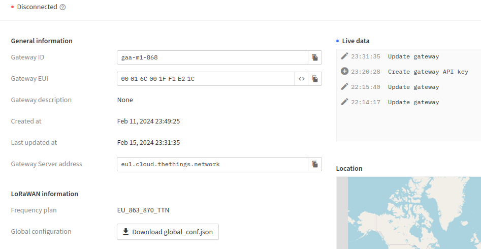

The strangest thing was that I decided to copy the correct json config file to a new file just called “global_conf” and when I ran the packet forwarded script with this as the filename it sprang into life.
Anyway, as I say - happy to help as this thread is quite stale now.
Jonathan
Just remembered - I also added a random EUI generated by a web page I found. I added this to both the TTN portal and to the config file near the end.

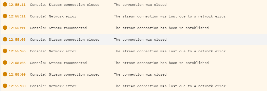

Did you also get the error “TLS server certificate verification failed”? I had to download up-to-date certificates into tc.trust.
