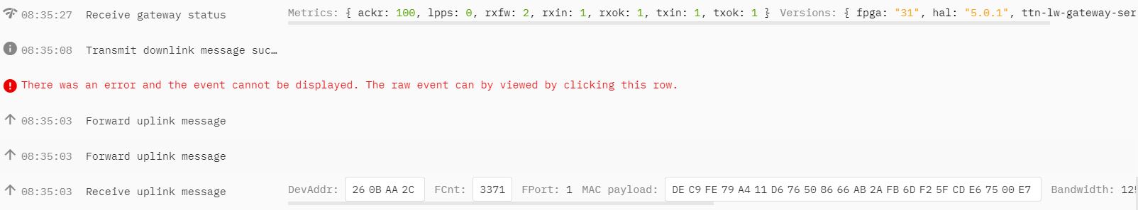

Sorry, I meant the Live Data of your gateway. You know your device-address from the config of your node, so you can see when some data is received from this device on your gateway and see what happens after that. Here an example of a dropped message:
When a messages is dropped, you will not see it on your End device Live data.
On this line you can see the FCnt = uplink count.

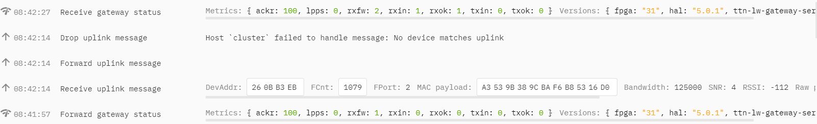

Thank you so much for the explanation. I just doubble checked my gateway Live data and End device Live data. Our gateway shows “Drop uplink message” with “Host cluster failed to handle message: No device matches uplink”. droped message
I just saw another errror message in gateway Live data and I want to show you too. error message
What do you think, is it a Frame counter issue? How to reset Frame counter with TTN CLI? I mean, is there any guidance or manual to reset the Frame counter with CLI from TTN’?
