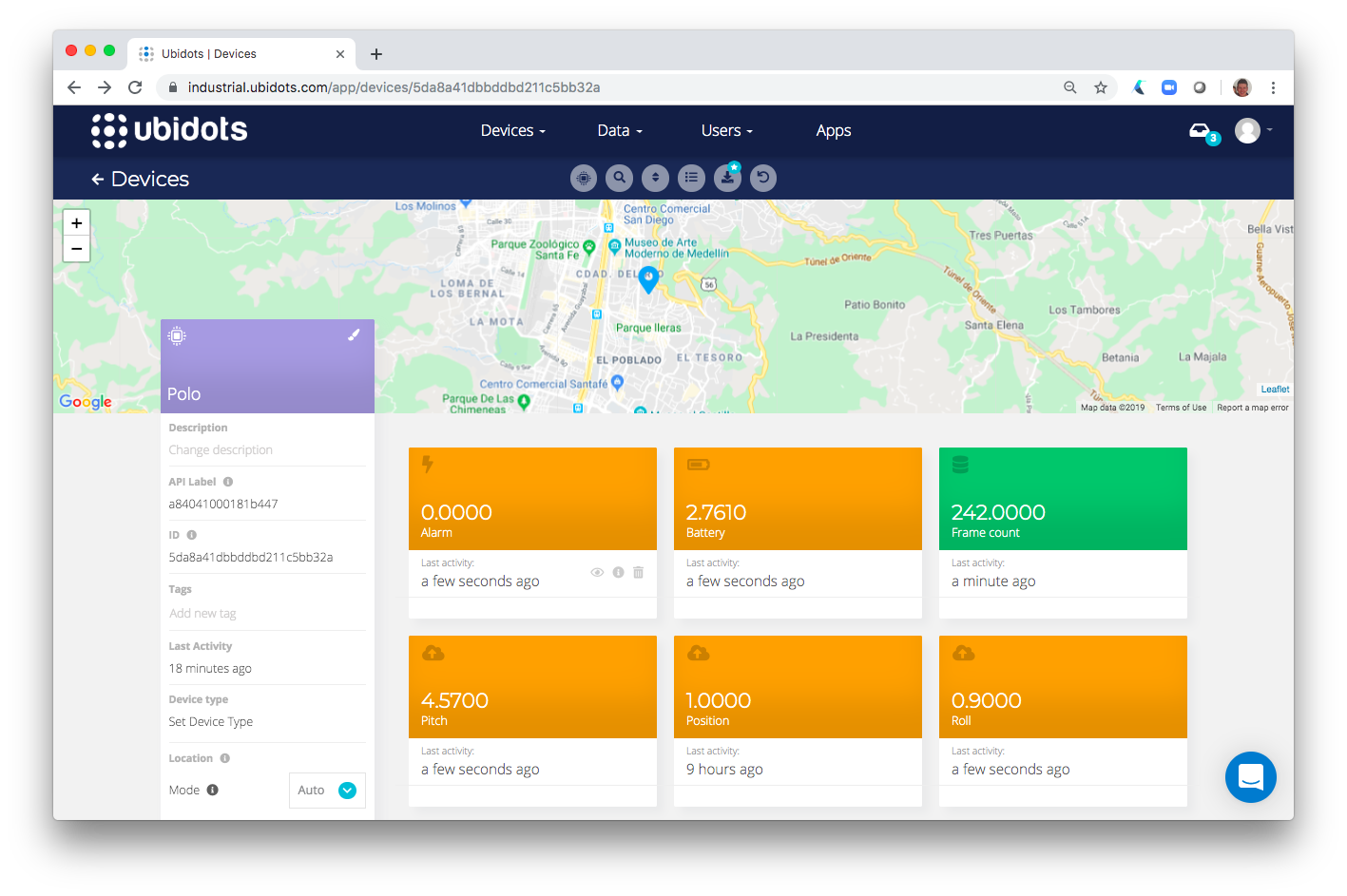

Hi everyone, Maria from Ubidots here. I just bumped into this forum while reading about the LGT-92 so I thought I’d jump in. I have an LGT-92 setup in my Ubidots account and is working just fine:
dragino
Please find my decoder below. I took the one in Dragino’s user manual and only changes one line of code so the returned JSON is one that Ubidots can understand as a position (needs to be a tuple, or within a “context”, as @KruisR’s attempt). In this case, I’m using a tuple:
JSON payload returned by the decoder:
“position”: {“lat”: 6.32122, “lng”: -75.23234},
“alarm”: false,
“batV”: 2.761,
“pitch”: 4.57,
“roll”: 0.83
Here my decoder:
