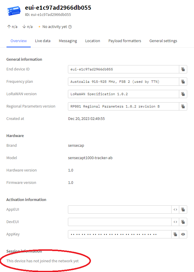

Hi, I just embarked on the journey with TTN and have been successfully using a Sensecap T1000 via the Sensecap TTN network and wanted to move direct to TTN and bypass Sensecap completely which in theory is possible as the device supports TTN direct. I ran into issues joining the T1000 onto TTN - I have good TTN coverage in my area however the T1000 will not join to the TTN everything seems to be setup OK but it just does not connect to the TTN Stack.
Any pointers or someone out there who has done this?

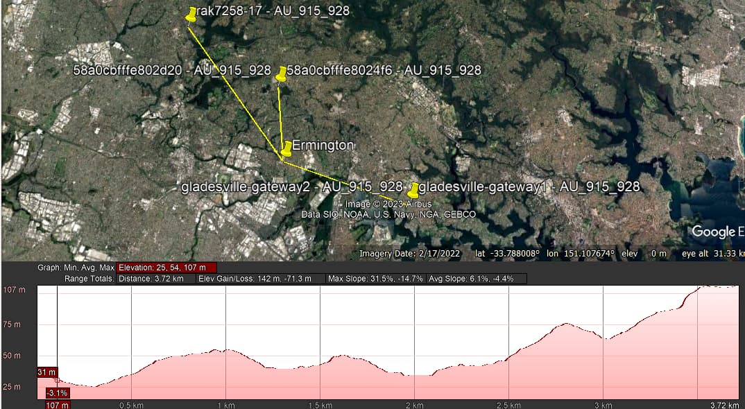

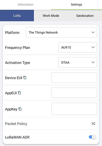

I have only one option in the device AU915 and yes AU915 chosen in either SenseCap TTN or TTN I wonder if I am just not close enough to a gateway for initial setup. I’m located in Ermington, Sydney and no gateway is particularly close but as SenseCap for TTN was working I presumed coverage is OK. My Office is in North Ryde so will attempt from there in the New Year.
there are a few in the area closest one from the center about 3.6km
so if you walk around like a mad man swinging a t1000 in the air you have a good chance of catching a packet
I think Piet_Pillay is on the money. Need to make sure your are set for Sub Band 2. BTW I have the 2 gateways on the map shown as Gladesville 1 & 2. Both are set for AU915 sb.2 If I remember correctly(on one of my other SenseCap devices) I couldn’t find the Sub band 2 setting and had to choose ‘Other network’ and then sub band 2. I have a few SenseCAP devices( all sensors and never a T1000) and in almost every case had to get help from Seeed support to get them working in AU. Sometimes it was a new firmware that they sent me to get them connecting. Maybe at a pinch my gateways may receive your device from North Ryde. Good luck.

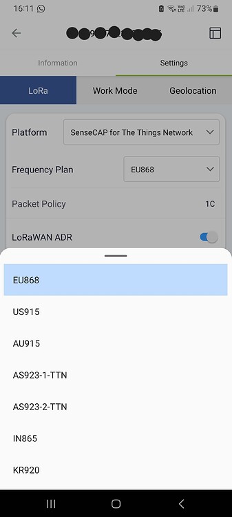

I have two of these and I can set them to the AS923 plans (I can’t test them as we are a EU868 region)
