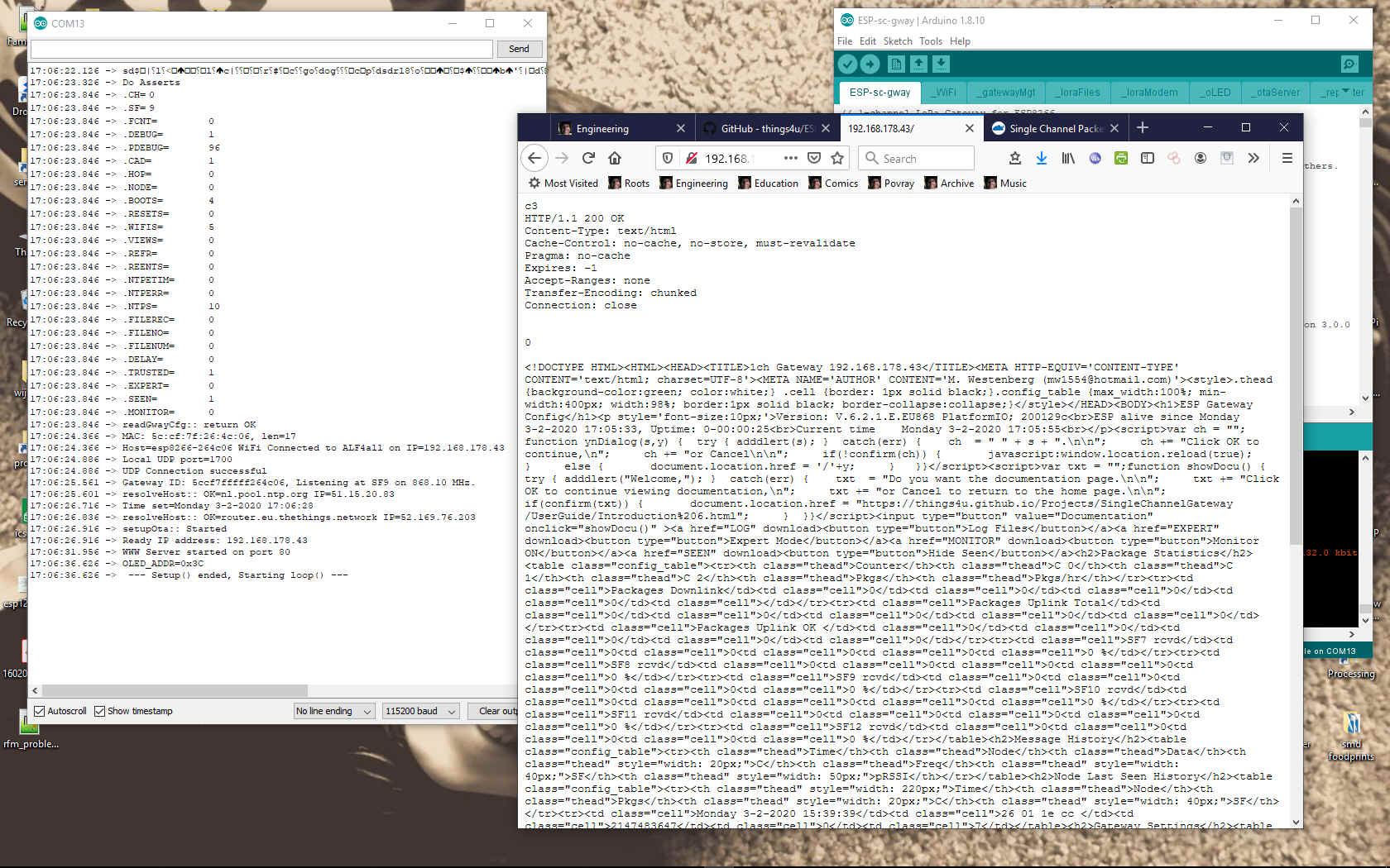

As end node it works perfect. Next step is to use it as single channel packet forwarder conform de software of Maarten Westenberg (6.2.0). After a lot reading, configurating and testing I came to the conclusion that the forwarder runs (not tested with end nodes yet) but the www-server gives me a lot ascii text in the browser (see next image)
Who can help me???
Thanks and regardsâŚ
The ASCII text is HTTP Response headers followed by the HTML for the page, but for some reason it is not being correctly displayed. That c3 at the start looks wrong to me. Have you tried clicking on refresh or using another browser?

Browsing from 192.168.178.43: Firefox shows only ascii, Opera only a white screen, Explorer comes up with an error. Strange is, when I save the page and browse to that saved page, it works (also withe the c3 on top). OK, I am going to search deeper.
