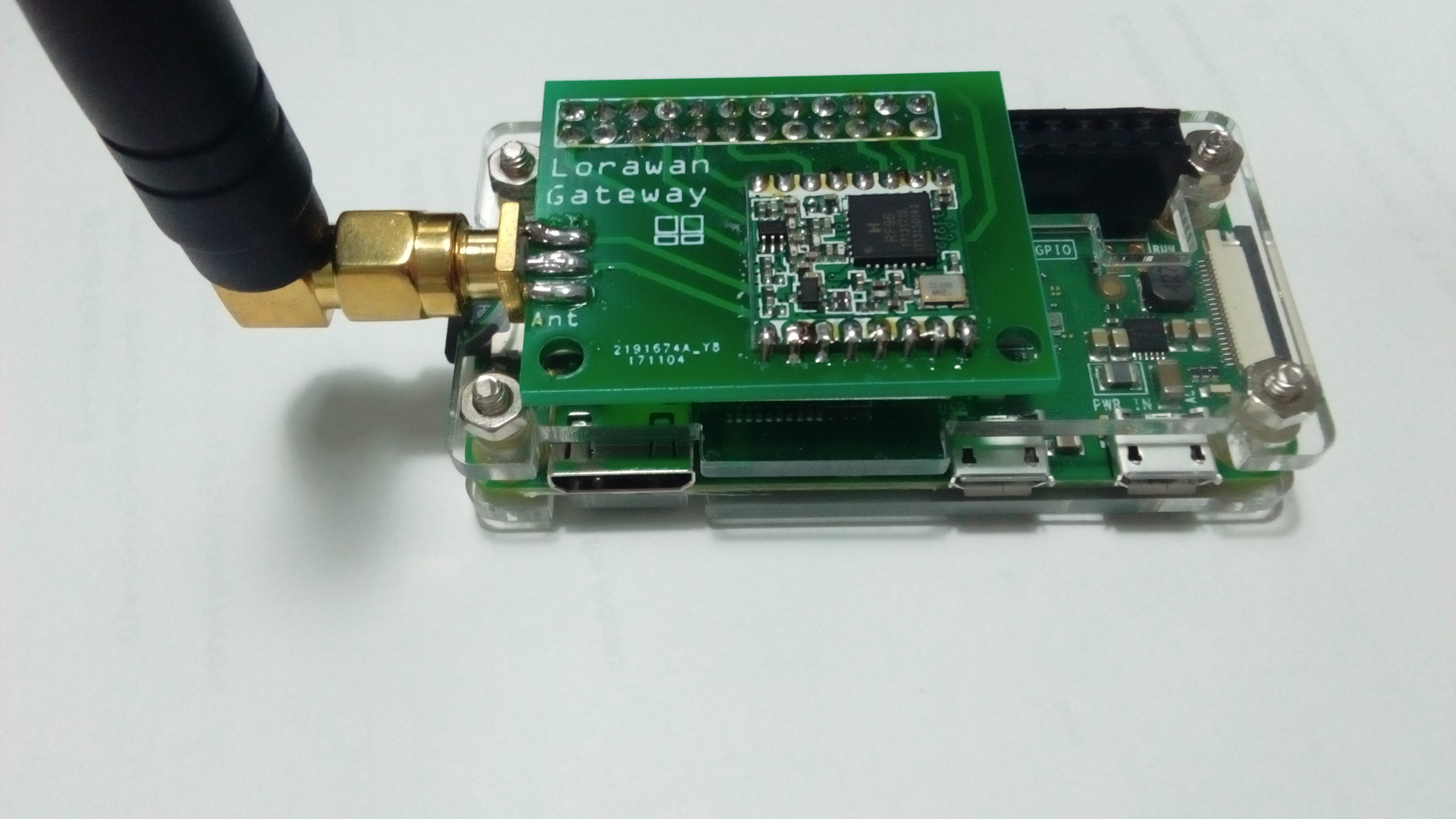

Pi Zero RFM95 Single Channel Gateway 460x446
Example hardware: Raspberry Pi Zero + RFM95 hat + Wifi dongle

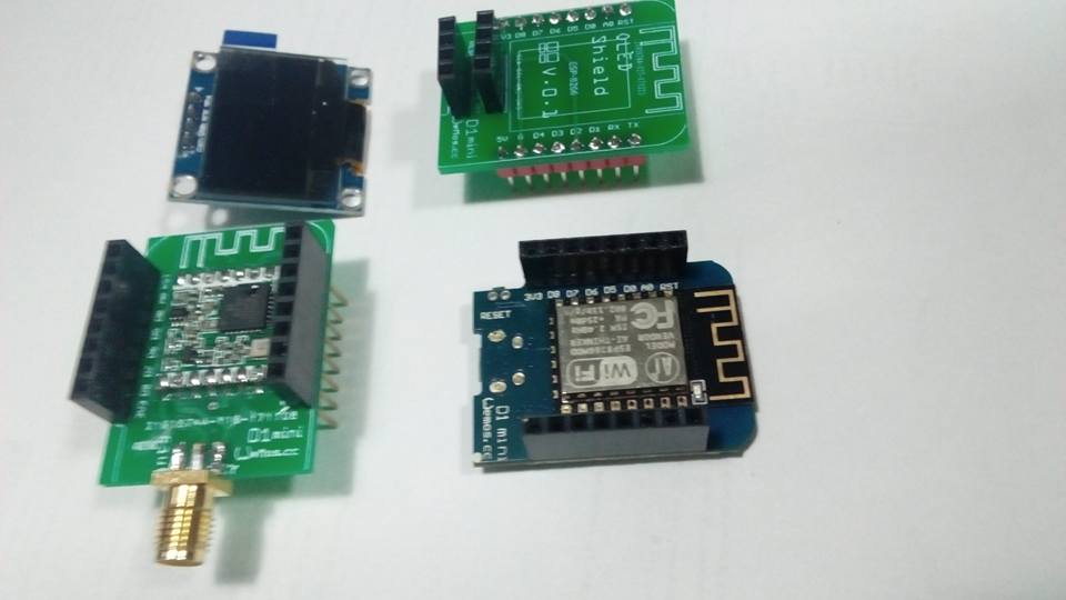

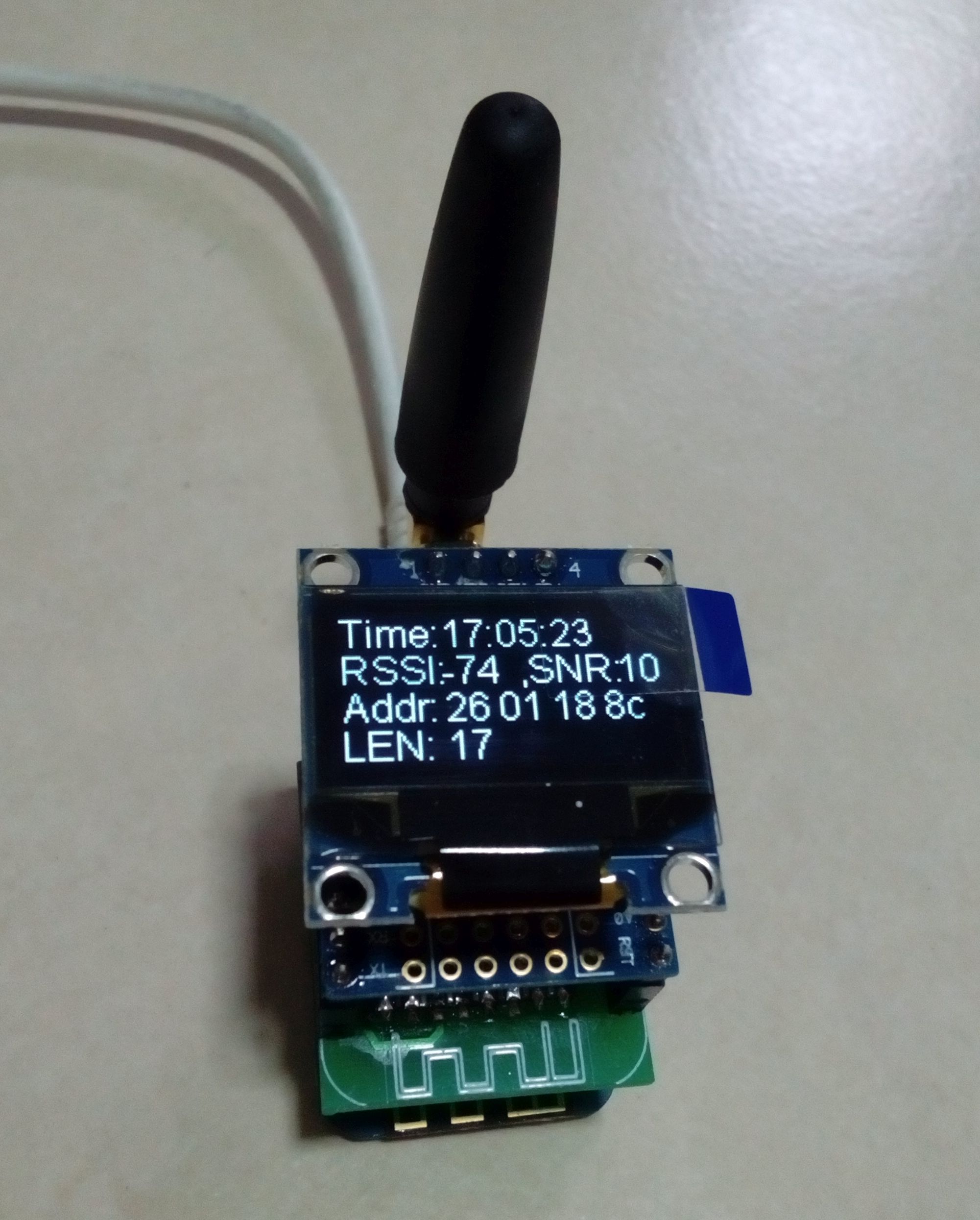

This is mine with Pi0w.
IMG_20171227_201430
ESP32(WeMos D1 Mini) + RFM95w + Oled

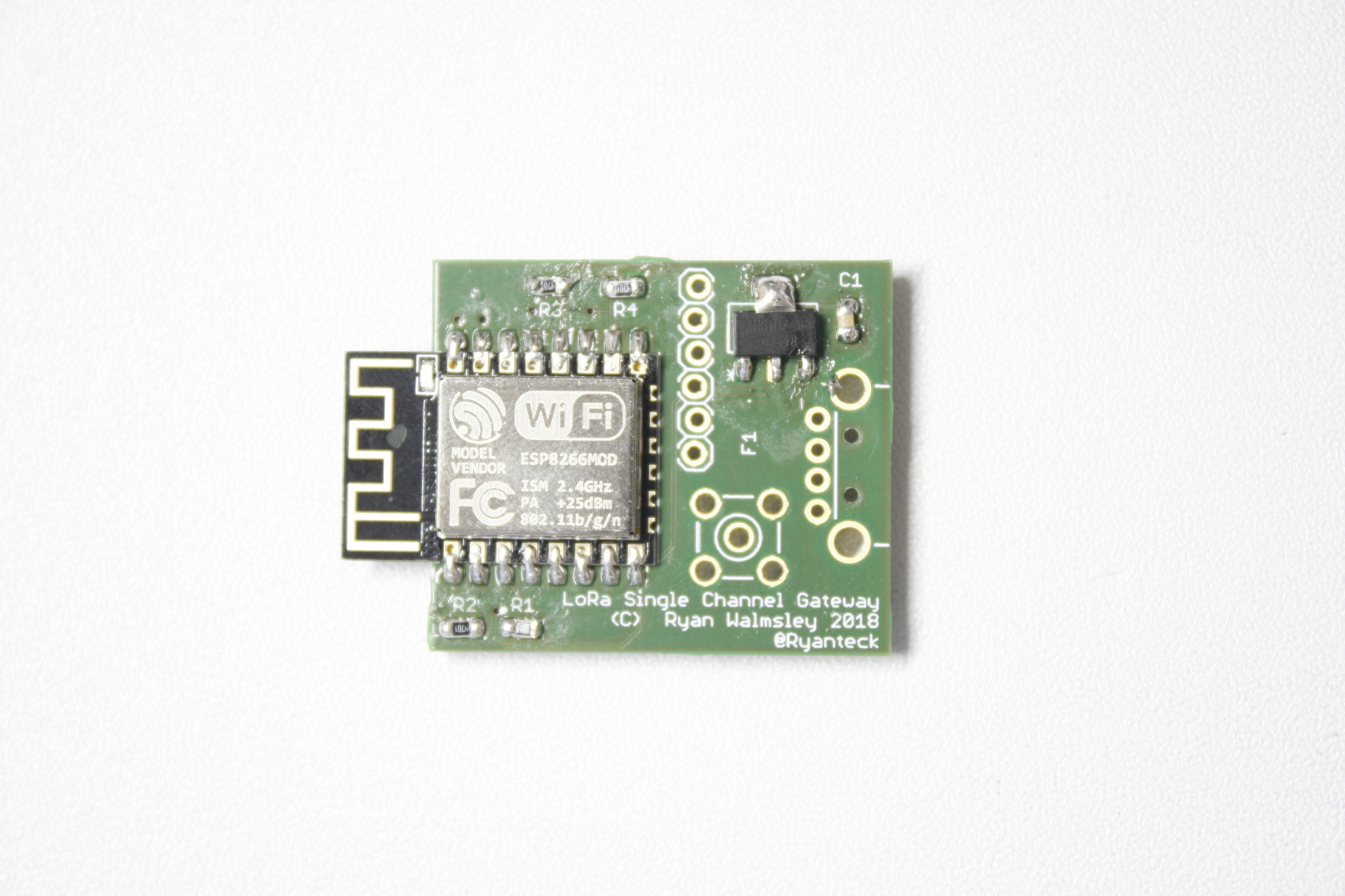

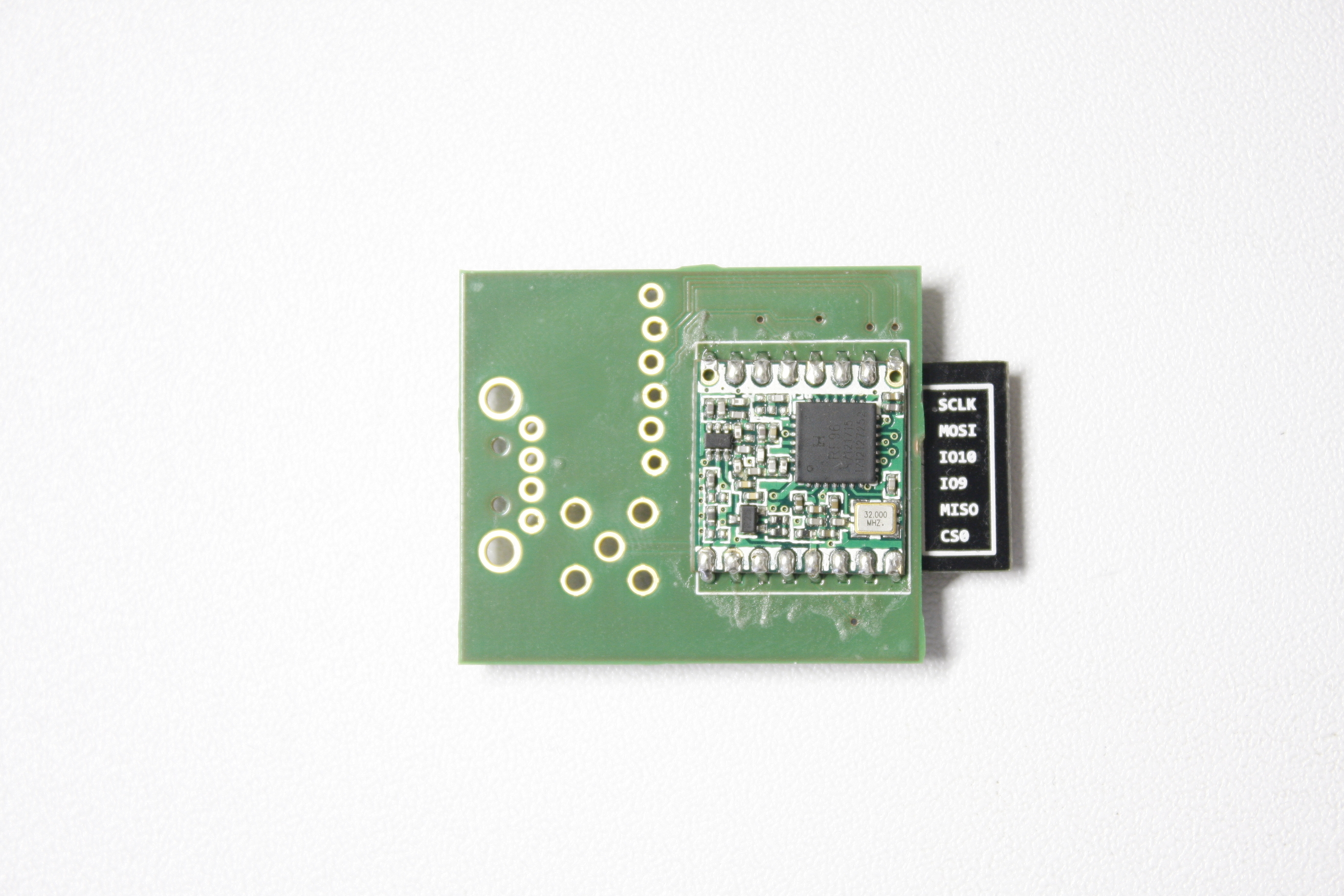

Just finished assembling this, A PCB that houses both the ESP8266 and RFM95 module on one PCB. Awaiting USB Connectors.
Designed to be a slightly more compact solution to plug into a USB Power socket on a phone charger.
Just need to figure out the software fully on it and do a few tests.
capture000289
capture000290
EDIT: All fully working using the V5 ESP Firmware. Should be ideal for a few development cases. I might have some spare boards and kits up for sale soon.
Update, Working great! Still awaiting the USB connectors.
SF auto switching seems to work perfectly fine. I’ll get the Eagle BRD File up on github Monday if anyone wants to get their own made. Around £10 for 3 PCBs from either OSH Park or Aisler Total build cost per unit around £10. (£3 PCB, £4 Hope RF, £1.50 ESP, £1.50 Misc)

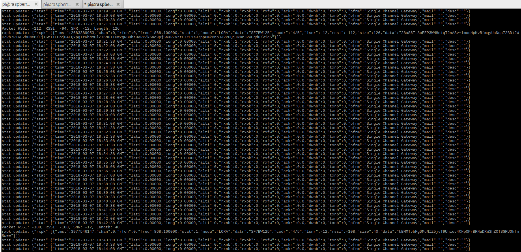

Hello people. I’ve implemented the single channel gateway with a SX1276 (specifically Dragino Lora Bee).
Right now the Raspberry shows the following receptions (attached). In the capture I receive a packet with a working node that contains the word “PONG” but I’m not seeing exactly that. Another thing is the node is sending this packet every 3 seconds but the gateway receives every 15 minutes or more.
I don’t really know if this is the correct functioning.
Please sorry my not-experience about all this but I’d really appreciate your help.
Selection_001
@fblanc92 , Single channel gateways are not “proper” gateways, most SCGs run on “Channel 0” or 868.1Mhz. A LoRa Wan compliant gateway can listen on 3 channels with most listening on all 8 for full compatibility.
At the same time nodes can transmit on any of the 8 channels, of which your gateway can only receive on the one channel.
As of this if your node is deciding to transmit on other frequencies more often then your gateway won’t be recieving them.
As of now there’s currently no way I know that allows a single channel gateway to listen on all 8 channels. However for development only you can force your node to transmit on only 868.1 Mhz. It’s only recommended that you do this while developing / don’t have coverage with a full gateway.
How to do this will depend on what you’re using as your node.
