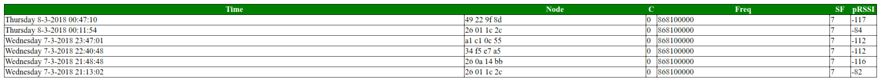

Just something I noticed, Not sure if its a single channel gateway hardware or software issue.
I seem to be picking up something every hour with random Dev addrs. (the ones ending in 2C are correct and also picked up by my multi channel gateway.
Screenshot%20from%202018-03-07%2023-52-22
You’re assuming those are DevAddr’s. But it might not even be LoRaWAN. You need to know the secrets to validate the MIC, to be sure it’s a valid LoRaWAN packet. You might be looking at plain LoRa, unrelated to LoRaWAN.

That’s plain abuse in EU. But even then: 32 bytes plus, at least, 13 bytes overhead does not explain either the 126 nor the 40 bytes you’re seeing once “every 15 minutes or more”. (Nor the 70 bytes you’re showing in your last post.)
In hexadecimal, that starts with 0xD4 so does not seem to be a valid LoRaWAN packet.
