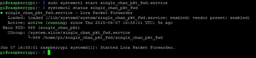

@telkamp Please excuse the completely noob question, but I am trying to use your hallard implementation, but can’t seem to find the Gateway Id. Everything seems to work fine but it just starts and stops without telling me what the id is, as per the below picture. Please could you explain where I’m going wrong?Capture
In advance, thanks a lot! Several hours of Googling don’t seem to have helped, so lets try people!
It would be shown in the log file, or you can work around not seeing it by starting the packet forwarder like below:
./single_chan_pkt_fwd/single_pkt_fwd
Assuming that you are in the pi folder. Also this should be obvious but sometimes people forget so before you run that command make sure you stop the service with sudo systemctl stop single_chan_pkt_fwd.
Perfect, thanks very much @glbaum ! Just one point for anybody else with this problem in the future, running this command from the pi folder didn’t work (I assume a permission issue), but going into the single_chan_pkt_fwd folder and running ./single_chan_pkt_fwd worked perfectly.
I don’t necessarily remember if I needed to use sudo to run it outside of it’s folder but maybe that’s the case. I just know that I had been able to start it that way, but either way I’m glad you got it working @Paul_B!

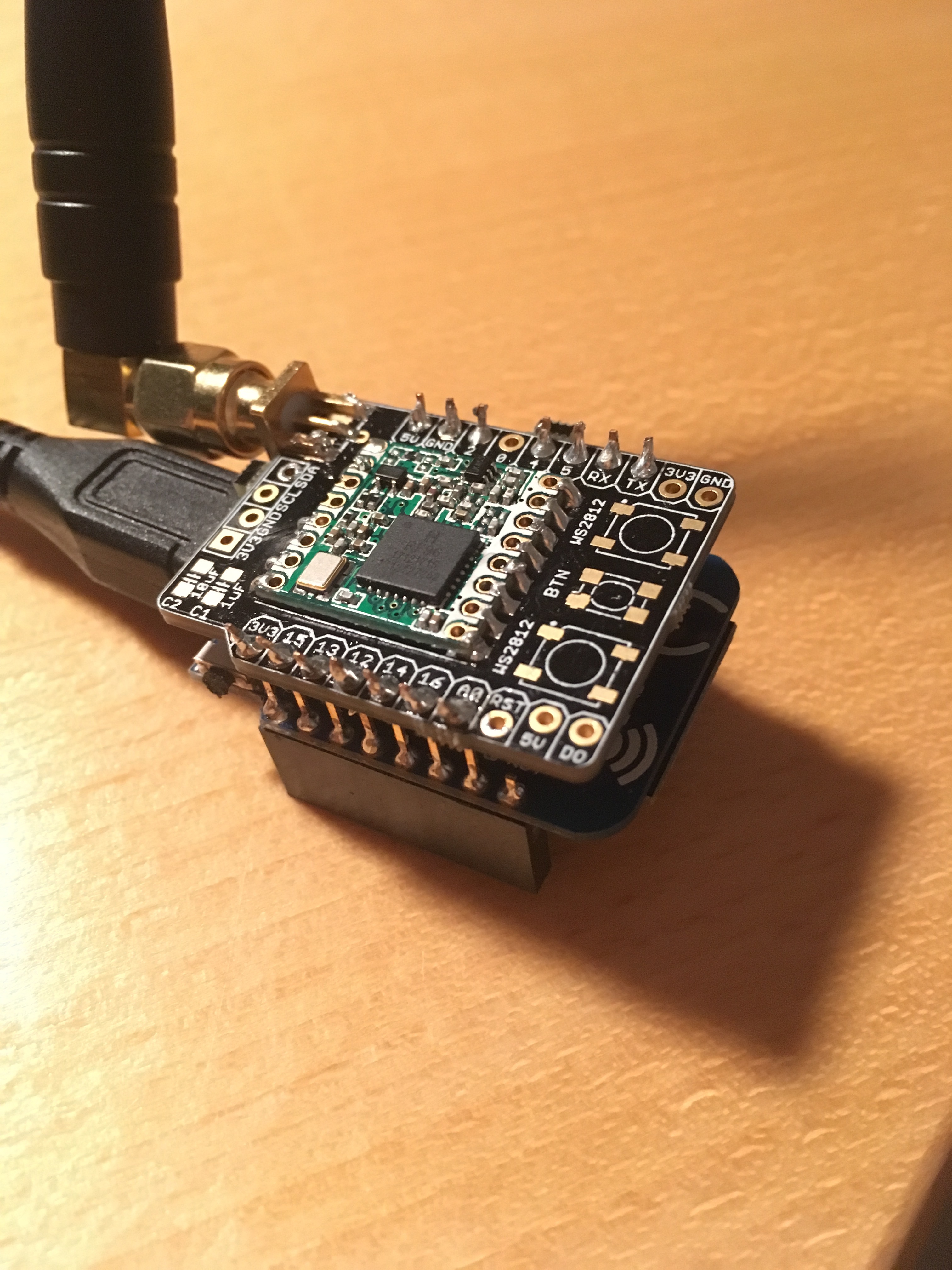

Hey all, I’ve built a small 1CH gateway based on a Wemos D1 mini, Ch. Hallard’s connection board (V1.3) and a RFM95. I configured things4u/ESP-1ch-Gateway-v4.0 is used to run it …
Now, on the serial monitor I am getting
Unrecognized transceiver, version: 0
Abort called
and the gateway is not connecting to ttn (nor to my wifi)
Interestingly, I had it once running when - for preliminary tests - the D1 and the Hallard board (with RFM95 and diodes D2, D3, D4 soldered on to it) were connected with wires, omitting RST and D0. After soldering everything, I can not get it up and running again. I checked all the connections several times, tried to improve the soldering joints, … still not working. Could it be any other issue than bad soldering? Has anybody experienced similar problems? If so, how was it solved? Thanks a lot for any hints!
(Sorry, I am pretty much a beginner. But I try my best…)
IMG_0077
Have a look at the following YouTube clip from @SensorsIOT: https://youtu.be/ZV_ZY-0Q1lo.
I built one up following it step by step and it worked jusr fine. Note the comments on which diodes to solder in and which ones not.

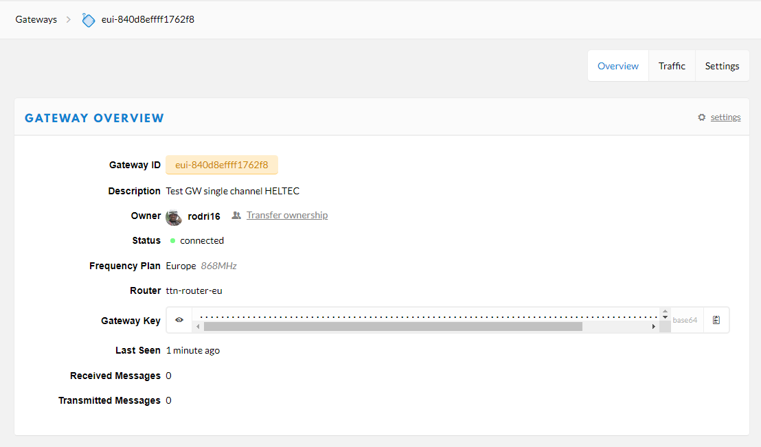

Hi, I am using an Heltec LoRa 32 v2 Board to create a GW. SS:18, RST:14, DIO0:26, DIO1:34, DIO2:35 (working ok as node)
I have it connected to TTN but I don’t receive any message from nodes.
Using library from Kersing
Both GW and nodes are using channel 0.

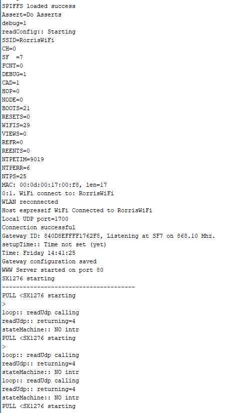

From the Serial log I get:
and sometimes
SCAN:: CADDETD,
loop:: readUdp calling
PKT_PULL_ACK:: size 4 From 52.169.76.203, port 1700, data: 1:93:25:4:
readUdp:: returning=4
SCAN:: CADDETD,
STAT <stat update: <232> {“stat”:{“time”:“2018-10-05 14:55:17 CET”,“lati”:0.00000,“long”:0.00000,“alti”:8,“rxnb”:0,“rxok”:0,“rxfw”:0,“ackr”:0.0,“dwnb”:0,“txnb”:0,“pfrm”:“ESP32 HELTEC",“mail”:"rodri16@gmail.com”,“desc”:“My ESP32 Gateway HELTEC”}}
WiFi connected
What am I doing wrong?

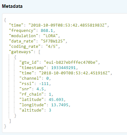

Both nodes work on a full GW, this is the metadata I get from the full gateway (ABP mode)
