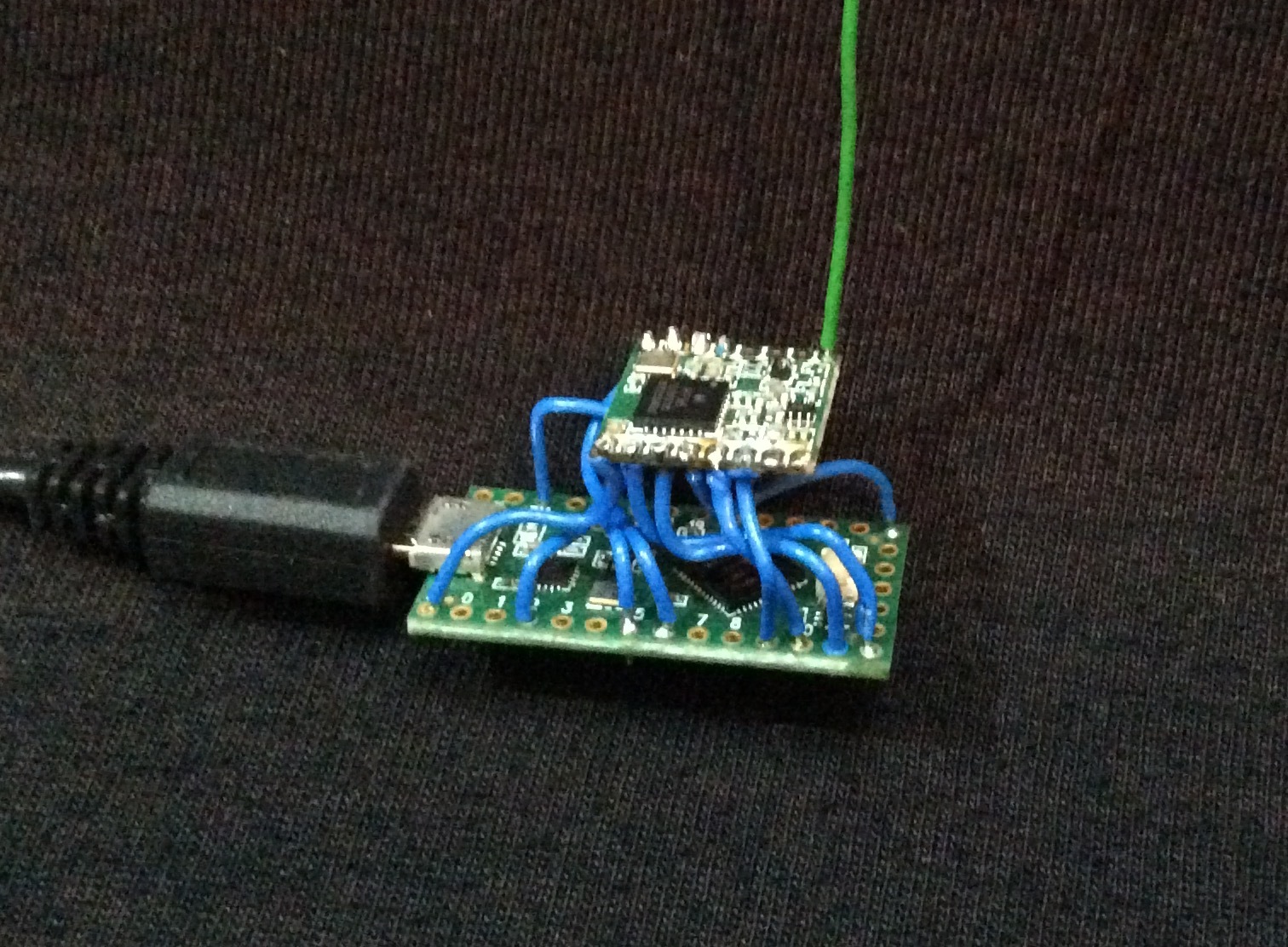

just an idea … is this feasible ?

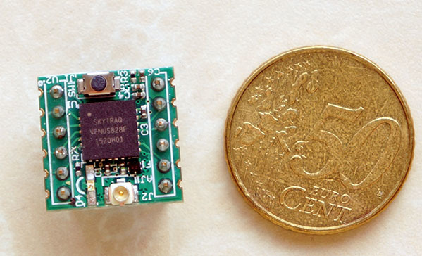

NavSpark mini + RFM95W
that would create a small TTN node with GPS

hi thomas
sorry a typo, I’m using a HOPE RFM95W/868MHz

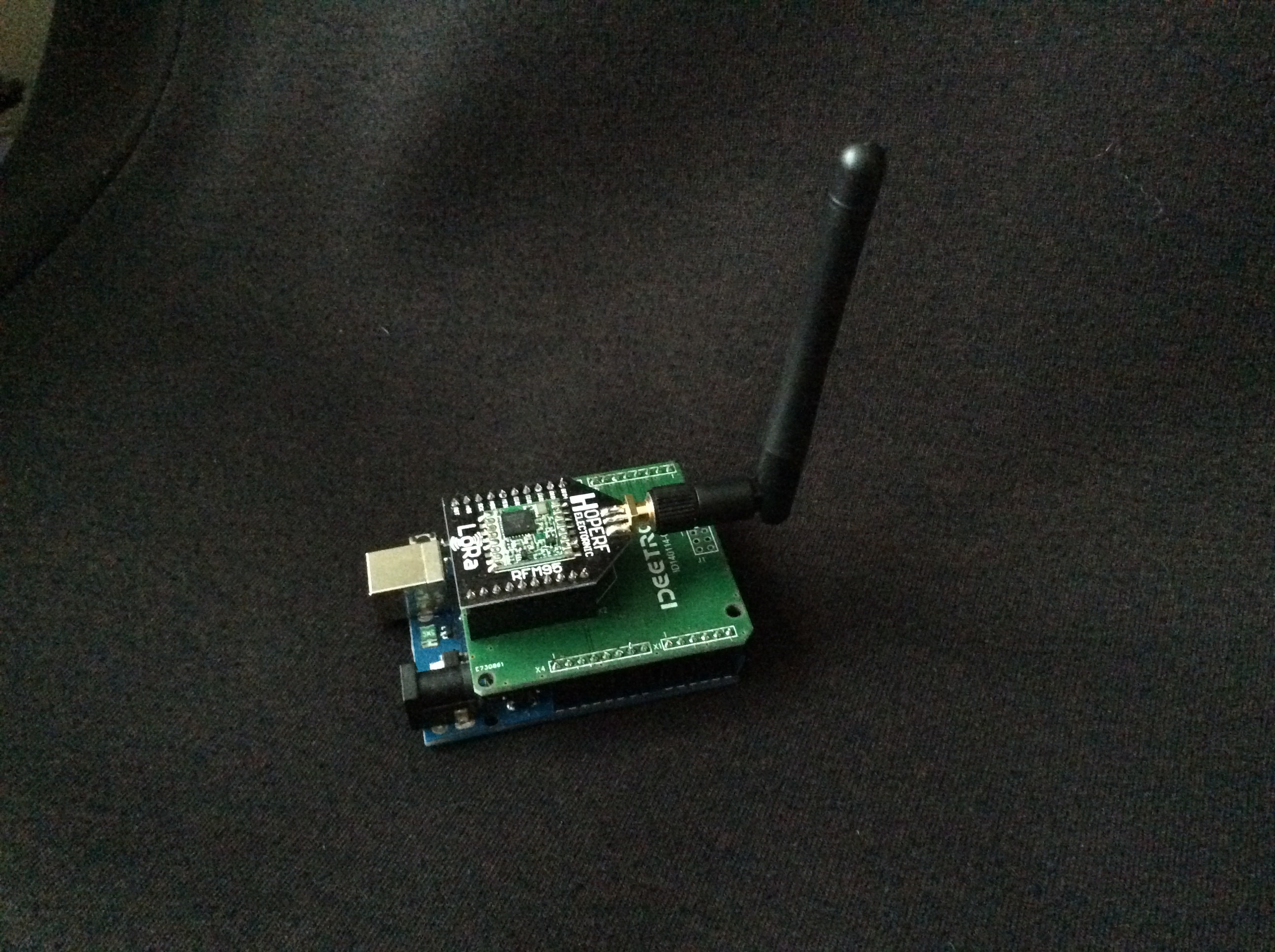

my node (arduino + hope xbee shield + xbee-adapter + rfm95w)
IBM LMIC with change in lmic/config.h
#define CFG_eu868 1
//#define CFG_us915 1
//#define CFG_sx1272_radio 1
#define CFG_sx1276_radio 1 <----

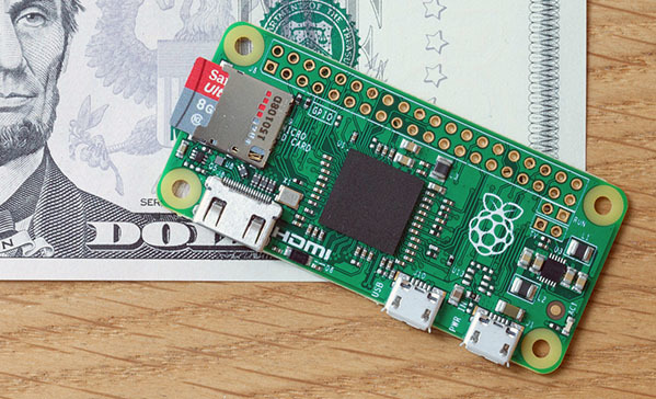

new : raspberry PI zero

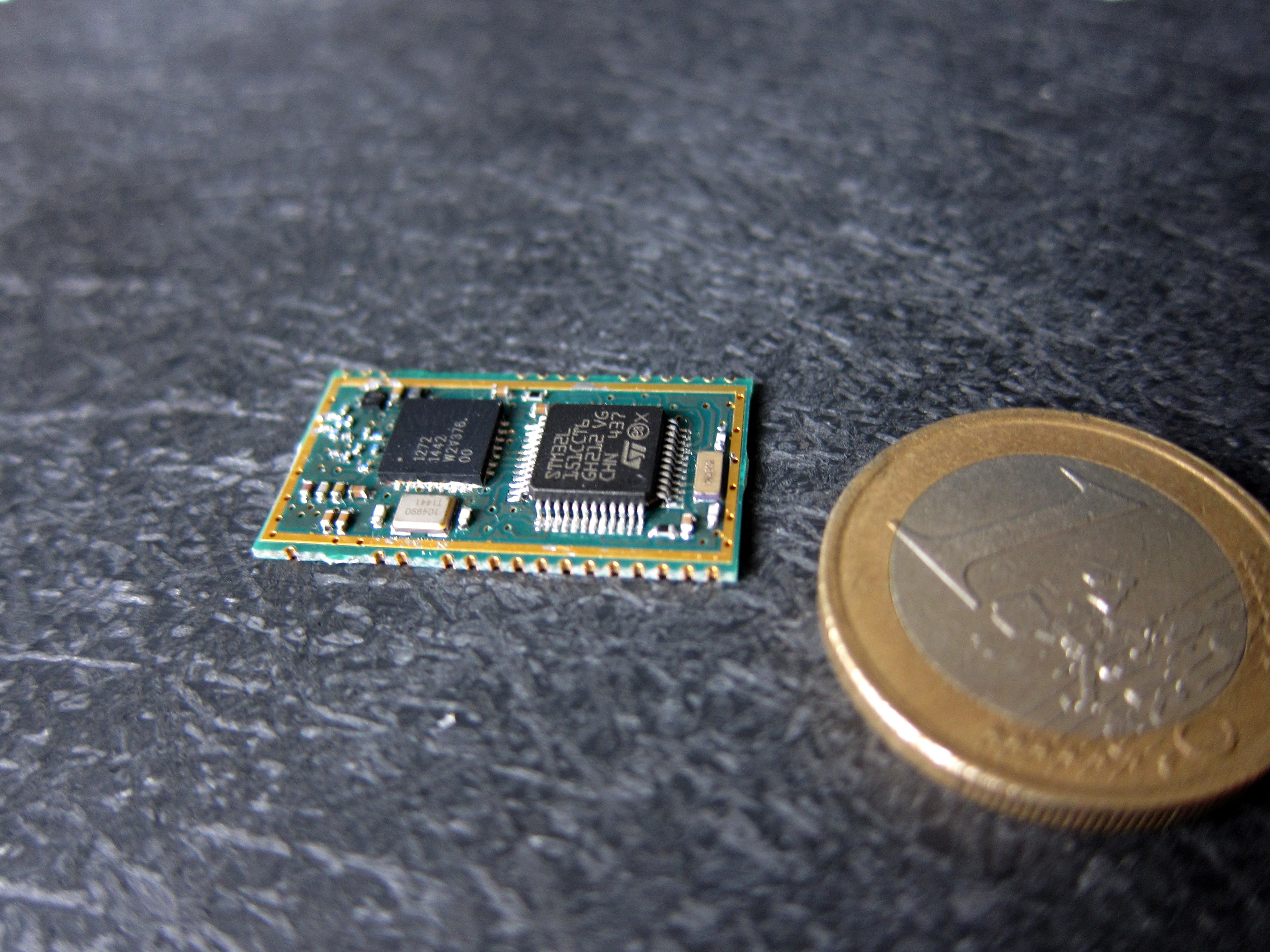

There is this module from Nemeus (with also sigfox if needed).

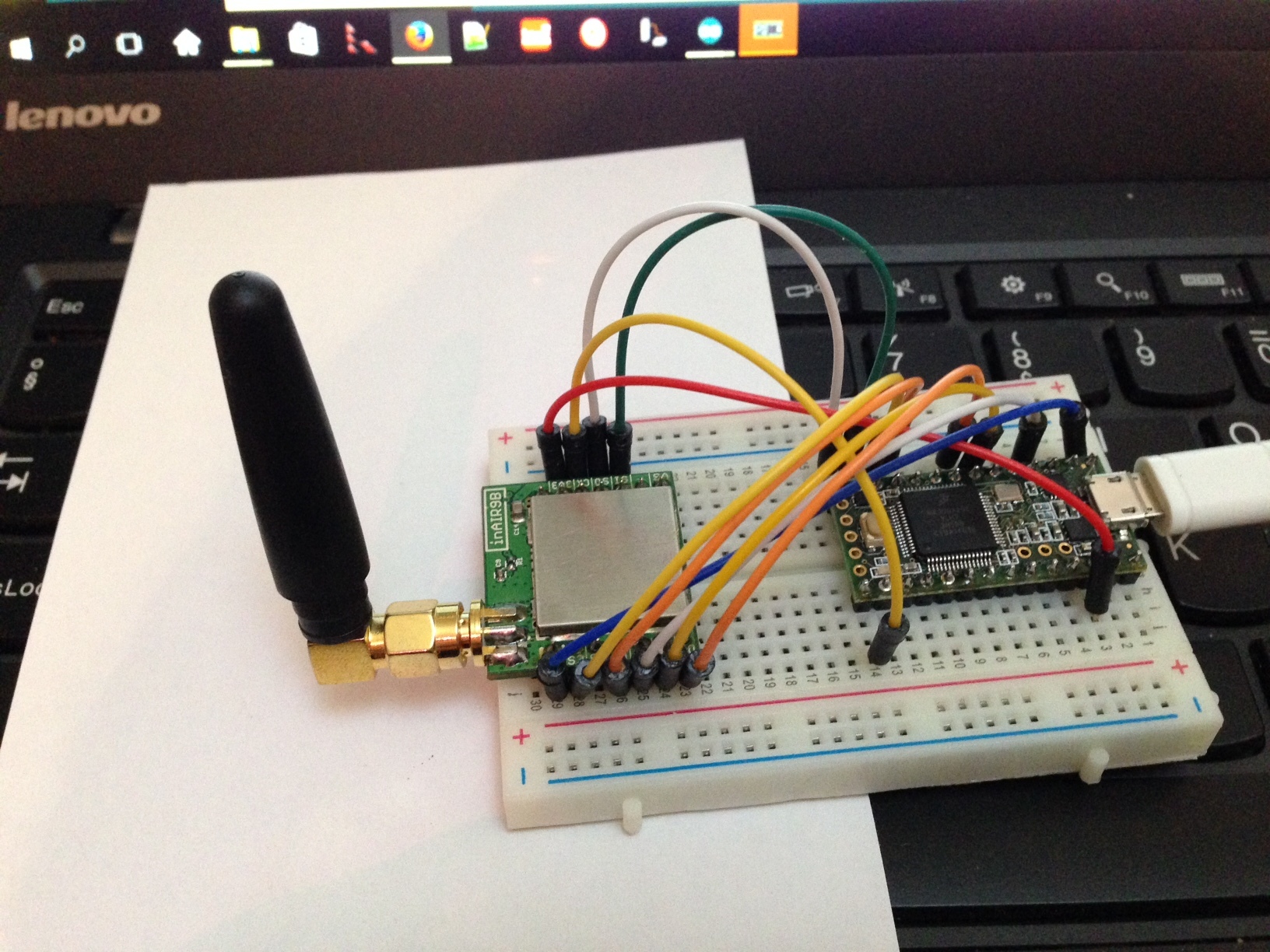

Another small node made from Teensy 3.2 & Modtronix inAir9B (SX1276)
wired as in WIKI : How to build a Teensy TTN node, tested with LMIC 1.5 and the ttn-send program
“data_raw”: “QKsBSFoAAAABg6SXO6k9RFDrykMgCCBRkZLSRqNwvd5QBENwhDSb/ZuHrw==”,
“gateway_eui”: “B827EBFFFFE05FEF”,
“node_eui”: “5A4801AB”,
“frequency”: 868.1,
“data_plain”: “Hello from Teensy3.2 & inAir9B”,
“time”: “2016-01-15T14:17:49.201Z”,
“rssi”: -47,
“snr”: 9.0,
“datarate”: “SF7BW125”,
“data”: “SGVsbG8gZnJvbSBUZWVuc3kzLjIgJiBpbkFpcjlC”
