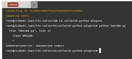

mmmhhh i tried this regarding your advice / comands in the shell
Clipboard03
this is the result where it stops
You probably have a problem the way you copied / imported the file if python complains about idents…

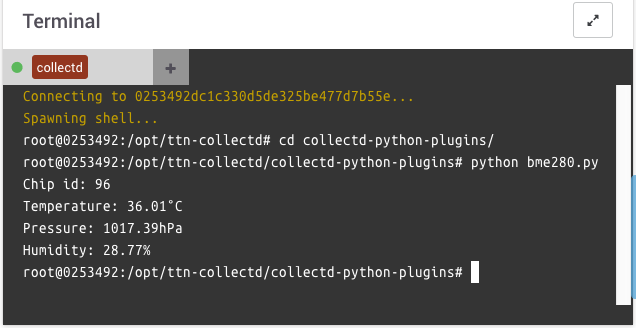

seems that this c&p was the reason ? or something else was wrong in the file i used before ? … well this is the result today:

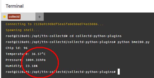

what i did before:
1.) i copied your original bme280.py from your link above to my notepad++
2.) then i renamed my original bme280.py to _x_old_bme280.py
3.) afterwards i saved the new file from your git to my local gateway folder
4.) i did then all the commands to update my balena folder online
5.) restarted the gateway from balena cloud
6.) again i typed your commands to read the values online from the sensor !
THANKS MEN !!! its working !! :partying_face:

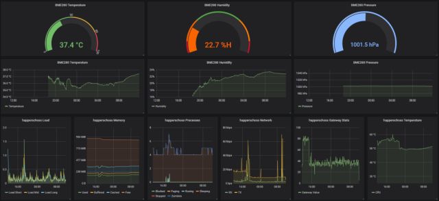

----- added 28th June 2019 — health of our local ttn gateway monitored in grafana
----- new values to read are Temperature, Humidity and Pressure
