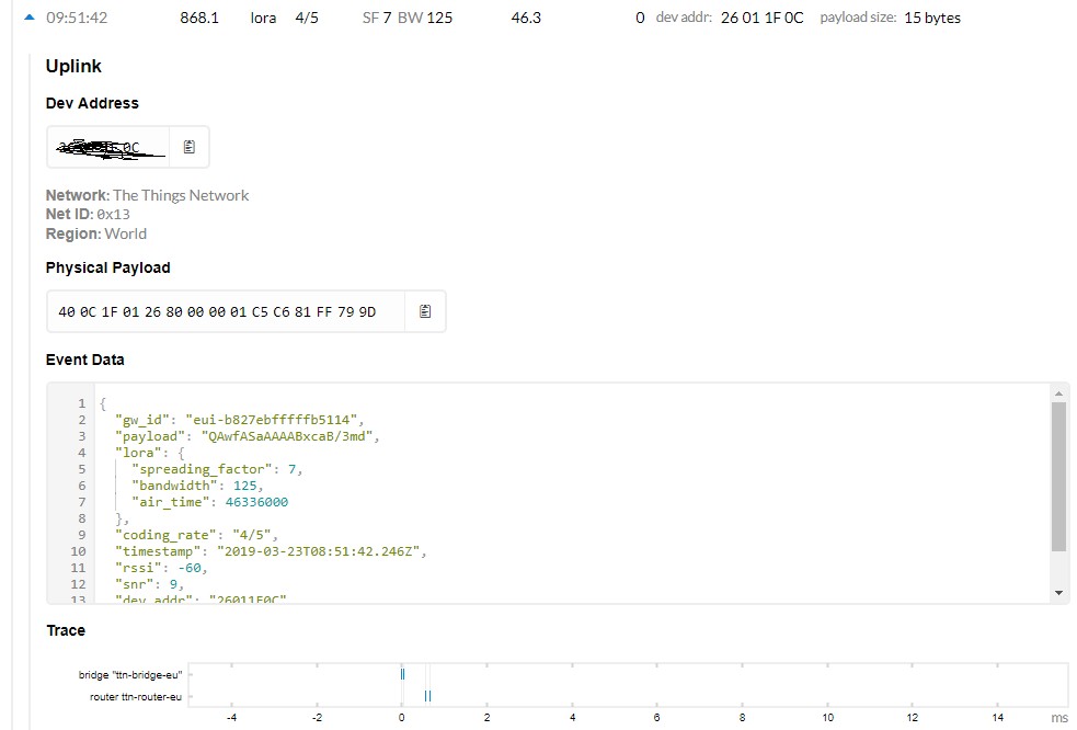

I have a question i stumble on the Lora node radio v1.0 this is a well designed lora node with battery and antenna for 20 dollar. I have expirence with other nodes and have an own packet forwarder gateway. Other nodes are working correct. But this thing won’t work. In the console of the gateway i see data come in with the correct dev key but no data to the node in the console. I switched of the Frame counter check. I have Copied/pastel the network and app key. I use ABP. Any ideas?

  • data from your console (screenshots/txt)
  • what code do you use - 8 ch gateway ?

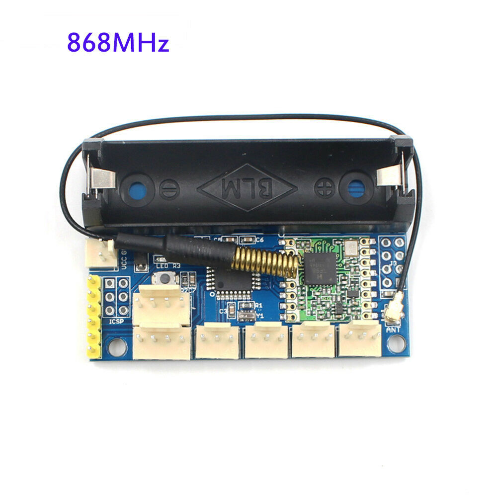

Thank you so much for your help. I have the following info:
gwtraffic

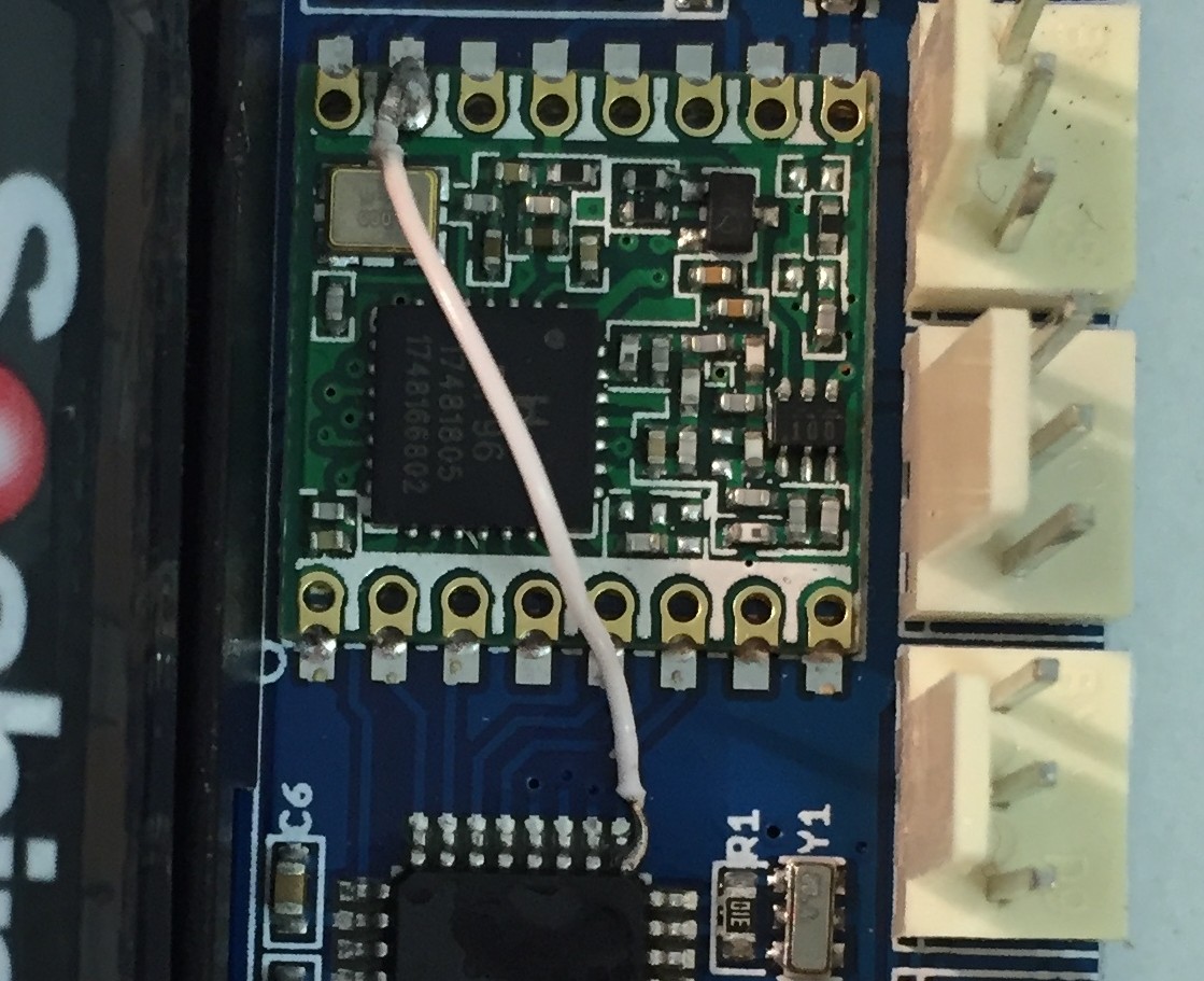

I searched and can’t find more info from this elecrow board.
Don’t know if the pinmappings in the code are correct, maybe need to mount an extra wire, only thing I see is that you are very close to your gateway with this node :wink:
  • update
found this :sunglasses:
wiretap
uncle Ali:

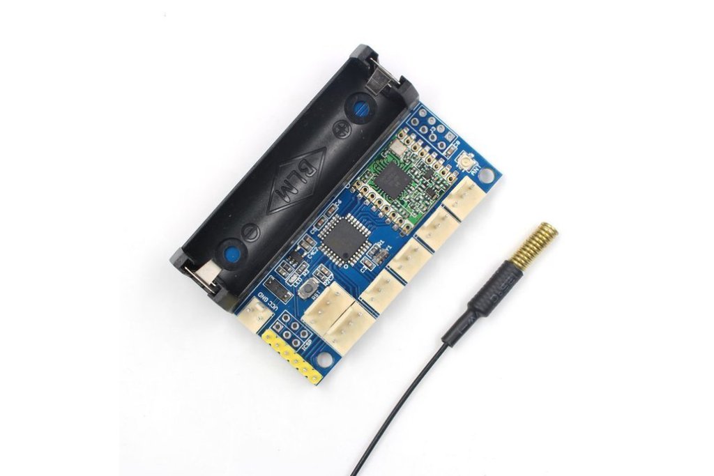

New board by Elecrow
#6
yes (see the above link) but don’t forget the wire :sunglasses:
(Jezd) #7
I just cut and pasted those from working code that was all, 100% use the jumper pins too - no need for soldering wires
