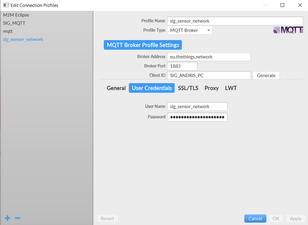

just tried with MQTT fx on PC, it worked like a charm,
here is my settings:
same as you:
user name is appid and password access key
