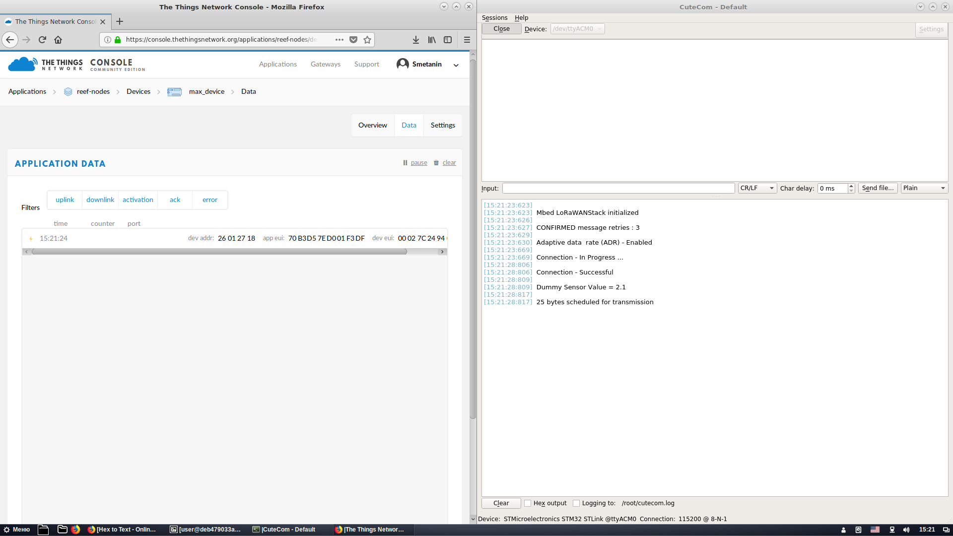

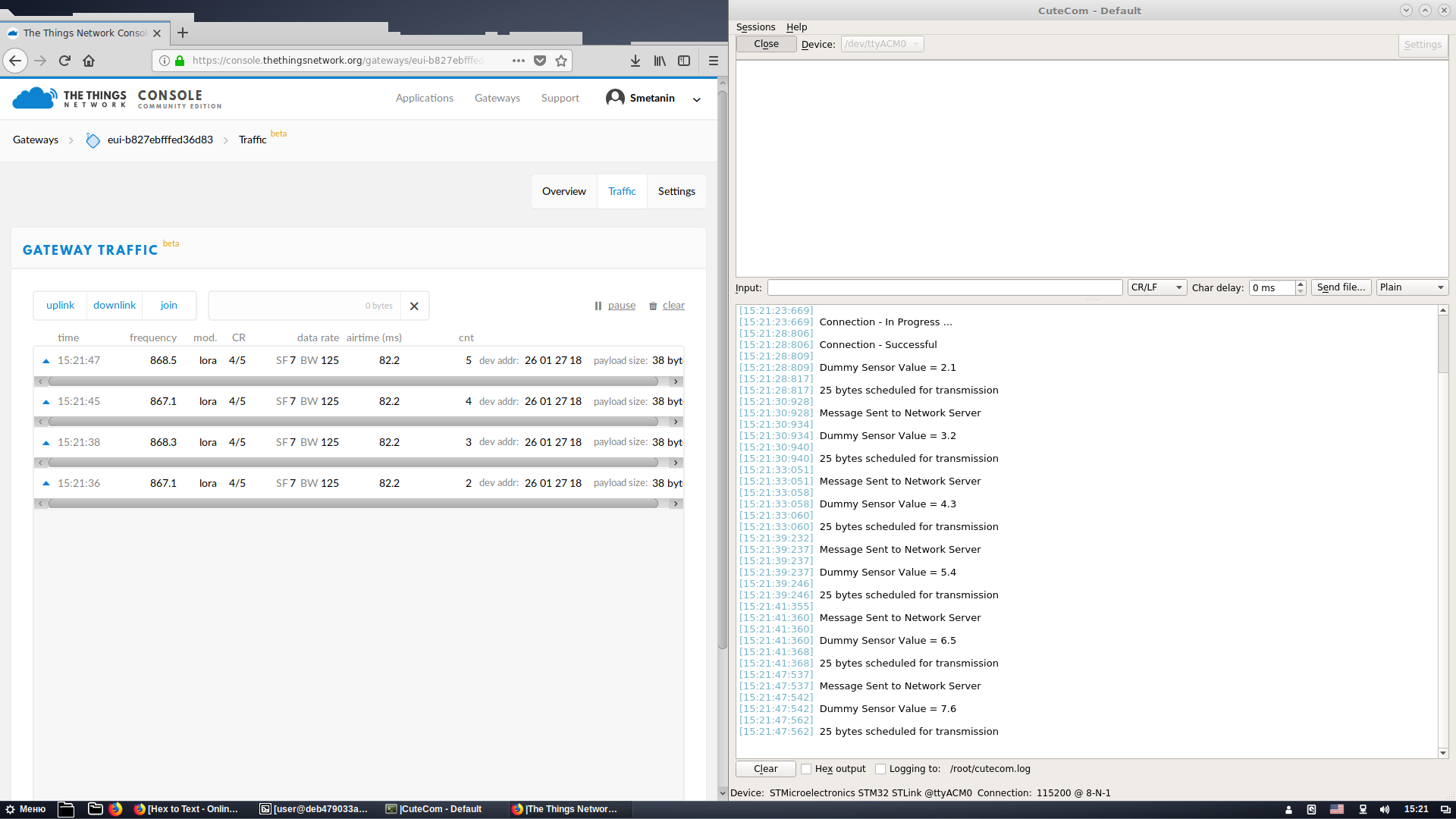

I have Raspberry 3B with IMST-IC880a-SPI and an end-node device NUCLEO-L073RZ with SX1272 Mbed Shield with mbed-os-example-lorawan program on it. Recently everything was alright, but today TTN Console shows me nothing in the Application Data menu, except join requests. At the same time, gateway shows all traffic and I see that it receives all the data, but for some reason I can’t see it in Application Data. Did anyone faced same problem?
There has been an outage this afternoon where no data was delivered to applications.
Thanks for the reply. Everything is working now.
