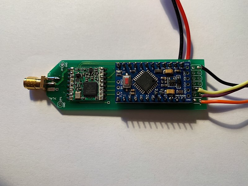

In our COM, we develop an LoRaNode caled Nucleon-Weathernode (WetterNode).
It is an Node based on a Arduino pro Mini, Hope RF 95, @Wijnand `s PCB and an BME280 as Sensor.
The sparepartlist you can find here: https://forum.iot-usergroup.de/t/nucleonbasenode328-arduino-328-pro-mini-lora-gehaeuse-antenne/287

The Software part you can find here: https://gitlab.com/iotssl/nucleon-nodes/tree/master/Weather/Weathernode_02
A sneak peak for results are in our Grafana. This Node are build at a learning session about LoRa and LoRaWAN made by @DasNordlicht at November 2018.

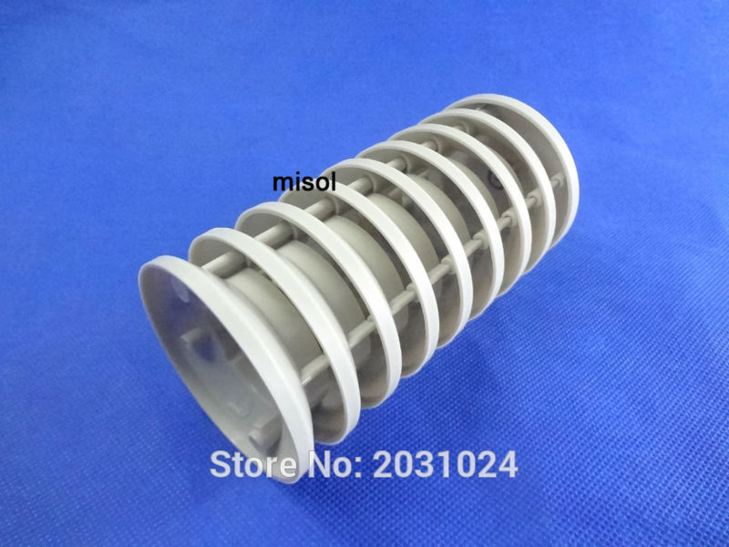

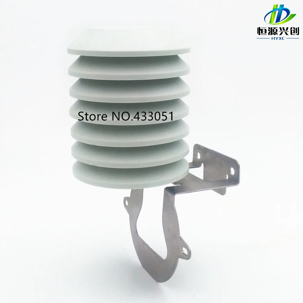

For reliable measurements you will still need a proper housing that protects the sensor from rain and (direct) sun light and that allows for sufficient ventilation. E.g. something like:
