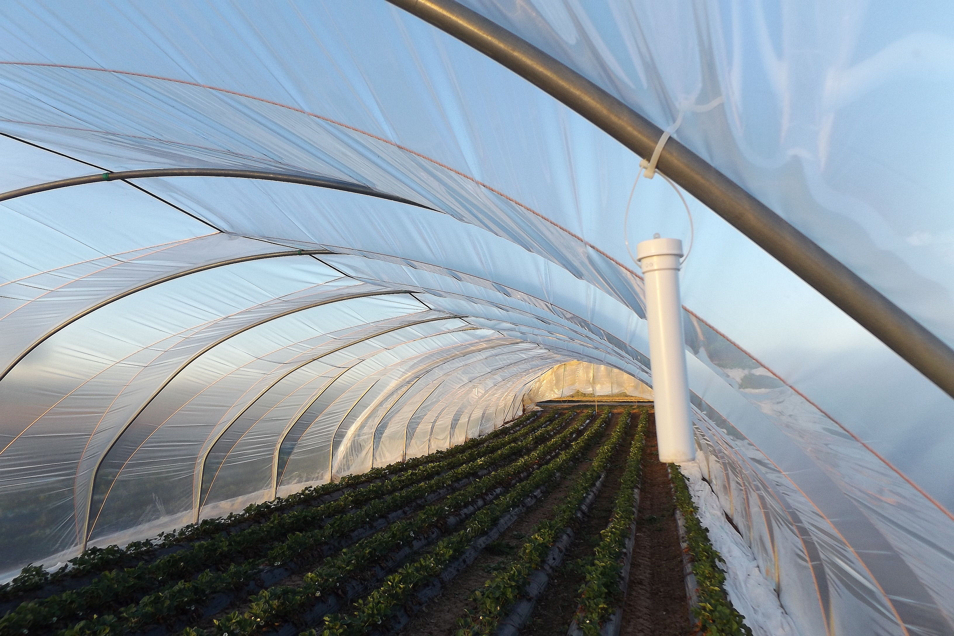

I have been using Sensirion SHT21 and SHT25 for many years, e.g. in strawberry foil tunnels with LoRa (not LoRaWAN) together with soil moisture sensors for irrigation control. You should pay attention to the following aspects:
At high humidity usually all sensors have less accuracy, some may even fail after long term exposure to high humidity (I remember a project in the tropical rain forests where we had quite some problems)
A good radiation shield may be required which can be quite expensive (more expensive that the whole electronics). In the foill tunnels I use a simple tube which is sufficient for this application.

One question if I may: Eg in your foil tunnel project, how did you protect the electronics?
I’ve been talking to people that studied electronics some had serious doubts DIY nodes would survive.

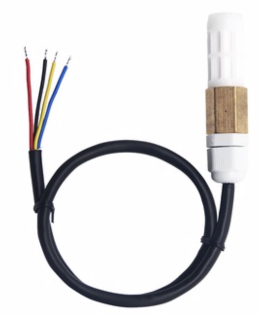

For my prototypes I usually put the LoRaWAN board into a IP67 case and just kept the breakout board with the sensor outside.
In long term I prefer something like on the picture below with an appropriate sensor inside:

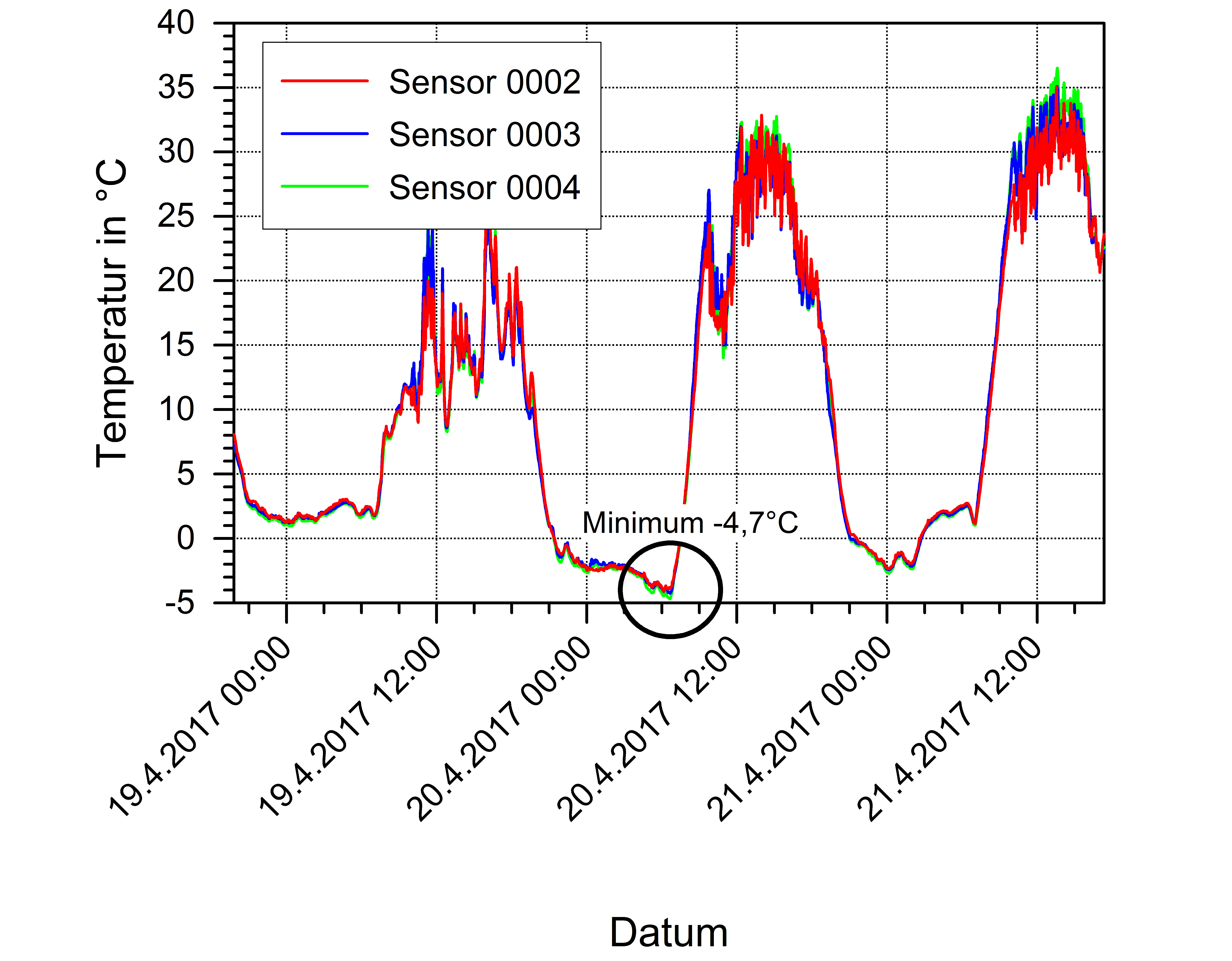

The best thing you can do is epoxy potting which I do for my soil moisture sensors and lasts for years. In the foil tunnel project I used Urethan 71 spray which worked quite well for a whole season with no degradation. Completely enclosed commercial sensors with filter are very good but quite expensive as far as I know (e.g. state of the art rotronic HygroClip). Below you will see some measurement results on frost detection (you mentioned in your inital post). In 2017 there was a severe frost event and the farmer lost 90% of the strawberries (we told him later why :-)) Don’t worry about the high daytime peaks, there was an insufficient radiation shield.
