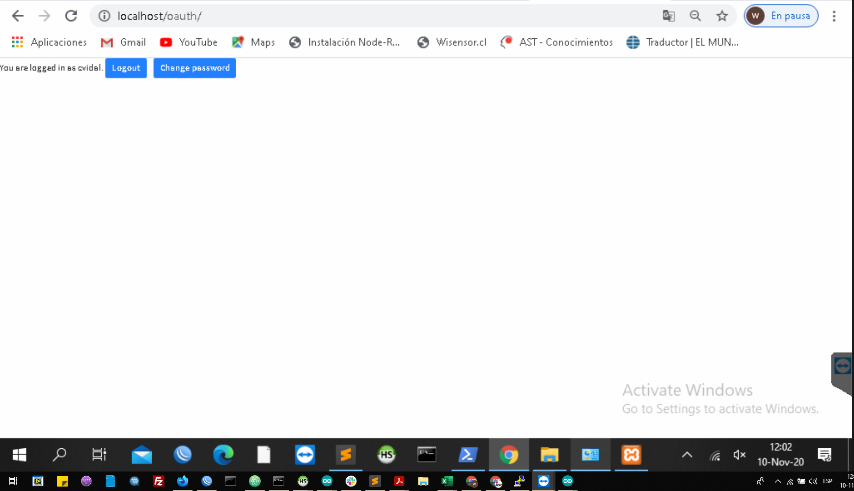

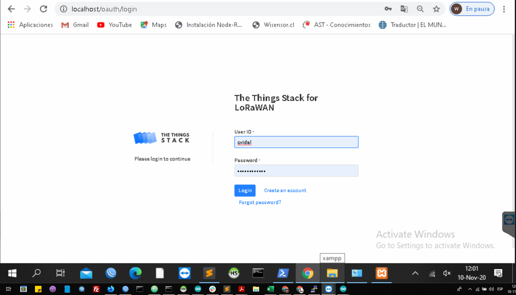

thank you! , I was able to complete the configuration and run TTS, I installed it in a localhost environment, my configuration files remained as follows:

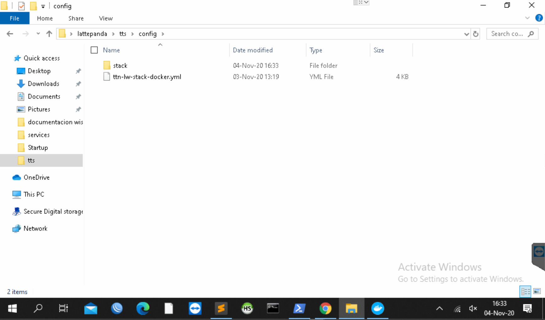

ttn-lw-stack-docker.yml:

start TTS with:
docker-compose up
the output I get is as follows:
Starting tts_cockroach_1 ... done
Starting tts_redis_1 ... done
Starting tts_stack_1 ... done
Attaching to tts_redis_1, tts_cockroach_1, tts_stack_1
cockroach_1 | *
cockroach_1 | * WARNING: RUNNING IN INSECURE MODE!
cockroach_1 | *
cockroach_1 | * - Your cluster is open for any client that can access <all your IP addresses>.
cockroach_1 | * - Any user, even root, can log in without providing a password.
cockroach_1 | * - Any user, connecting as root, can read or write any data in your cluster.
cockroach_1 | * - There is no network encryption nor authentication, and thus no confidentiality.
cockroach_1 | *
cockroach_1 | * Check out how to secure your cluster: https://www.cockroachlabs.com/docs/v20.1/secure-a-cluster.html
cockroach_1 | *
cockroach_1 | *
cockroach_1 | * WARNING: running 'cockroach start' without --join is deprecated.
cockroach_1 | * Consider using 'cockroach start-single-node' or 'cockroach init' instead.
cockroach_1 | *
cockroach_1 | *
cockroach_1 | * WARNING: neither --listen-addr nor --advertise-addr was specified.
cockroach_1 | * The server will advertise "2c63b6df56e0" to other nodes, is this routable?
cockroach_1 | *
cockroach_1 | * Consider using:
cockroach_1 | * - for local-only servers: --listen-addr=localhost
cockroach_1 | * - for multi-node clusters: --advertise-addr=<host/IP addr>
cockroach_1 | *
cockroach_1 | *
redis_1 | 1:C 10 Nov 2020 12:07:41.619 # oO0OoO0OoO0Oo Redis is starting oO0OoO0OoO0Oo
redis_1 | 1:C 10 Nov 2020 12:07:41.620 # Redis version=6.0.9, bits=64, commit=00000000, modified=0, pid=1, just started
redis_1 | 1:C 10 Nov 2020 12:07:41.620 # Configuration loaded
redis_1 | 1:M 10 Nov 2020 12:07:41.643 * Running mode=standalone, port=6379.
redis_1 | 1:M 10 Nov 2020 12:07:41.645 # WARNING: The TCP backlog setting of 511 cannot be enforced because /proc/sys/net/core/somaxconn is set to the lower value of 128.
redis_1 | 1:M 10 Nov 2020 12:07:41.645 # Server initialized
redis_1 | 1:M 10 Nov 2020 12:07:41.646 # WARNING overcommit_memory is set to 0! Background save may fail under low memory condition. To fix this issue add 'vm.overcommit_memory = 1' to /etc/sysctl.conf and then reboot or run the command 'sysctl vm.overcommit_memory=1' for this to take effect.
redis_1 | 1:M 10 Nov 2020 12:07:41.648 # WARNING you have Transparent Huge Pages (THP) support enabled in your kernel. This will create latency and memory usage issues with Redis. To fix this issue run the command 'echo madvise > /sys/kernel/mm/transparent_hugepage/enabled' as root, and add it to your /etc/rc.local in order to retain the setting after a reboot. Redis must be restarted after THP is disabled (set to 'madvise' or 'never').
redis_1 | 1:M 10 Nov 2020 12:07:41.701 * DB loaded from append only file: 0.037 seconds
redis_1 | 1:M 10 Nov 2020 12:07:41.701 * Ready to accept connections
cockroach_1 | CockroachDB node starting at 2020-11-10 12:07:51.5183637 +0000 UTC (took 9.3s)
cockroach_1 | build: CCL v20.1.8 @ 2020/10/21 15:46:38 (go1.13.9)
cockroach_1 | webui: http://2c63b6df56e0:26256
cockroach_1 | sql: postgresql://root@2c63b6df56e0:26257?sslmode=disable
cockroach_1 | RPC client flags: /cockroach/cockroach <client cmd> --host=2c63b6df56e0:26257 --insecure
cockroach_1 | logs: /cockroach/cockroach-data/logs
cockroach_1 | temp dir: /cockroach/cockroach-data/cockroach-temp517203340
cockroach_1 | external I/O path: /cockroach/cockroach-data/extern
cockroach_1 | store[0]: path=/cockroach/cockroach-data
cockroach_1 | storage engine: rocksdb
cockroach_1 | status: restarted pre-existing node
cockroach_1 | clusterID: 5e359357-7621-4a7a-a849-dcda9b85ba06
cockroach_1 | nodeID: 1
stack_1 | INFO Setting up core component
stack_1 | WARN No cookie hash key configured, generated a random one
stack_1 | WARN No cookie block key configured, generated a random one
stack_1 | INFO Setting up Identity Server
stack_1 | INFO Setting up Gateway Server
stack_1 | INFO Setting up Network Server
stack_1 | INFO Setting up Application Server
stack_1 | INFO Setting up Join Server
stack_1 | INFO Setting up Console
stack_1 | INFO Setting up Gateway Configuration Server
stack_1 | INFO Setting up Device Template Converter
stack_1 | INFO Setting up QR Code Generator
stack_1 | INFO Setting up Packet Broker Agent
stack_1 | INFO Starting...
stack_1 | WARN No cluster key configured, generated a random one key=3df2ac1088fa04d66f98c7597834d558d2fe0ea6e0d1a0fb051a3a1a96711e58
stack_1 | INFO Listening for connections address=:1884 namespace=grpc protocol=gRPC
stack_1 | INFO Listening for connections address=:8884 namespace=grpc protocol=gRPC/tls
stack_1 | INFO Listening for connections address=:1885 namespace=web protocol=Web
stack_1 | INFO Listening for connections address=:8885 namespace=web protocol=Web/tls
stack_1 | INFO Listening for connections address=:8886 namespace=interop protocol=Interop/tls
stack_1 | INFO Request handled duration=1.1354ms method=GET namespace=web remote_addr=127.0.0.1 request_id=01EPS0XZC5M8KF1EECB749Y3H4 response_size=3 status=200 url=http://localhost:1885/healthz/live
stack_1 | INFO Request handled duration=48.8µs method=GET namespace=web remote_addr=127.0.0.1 request_id=01EPS0ZTGPWJ9PSY9M743RAA1W response_size=3 status=200 url=http://localhost:1885/healthz/live
stack_1 | INFO Request handled duration=65.1µs method=GET namespace=web remote_addr=127.0.0.1 request_id=01EPS11NXQ2NFQ8Q6V51NTAY9V response_size=3 status=200 url=http://localhost:1885/healthz/live
stack_1 | INFO Request handled duration=129.3µs method=GET namespace=web remote_addr=127.0.0.1 request_id=01EPS13H4NT89FA7AH0ZBBTH04 response_size=3 status=200 url=http://localhost:1885/healthz/live

Once TTS started, I registered a user, when logging in redirects me to this screen but does not enter the console:
What could be wrong with authentication?
