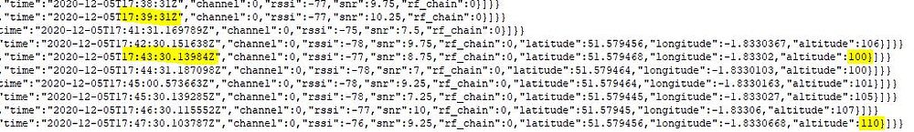

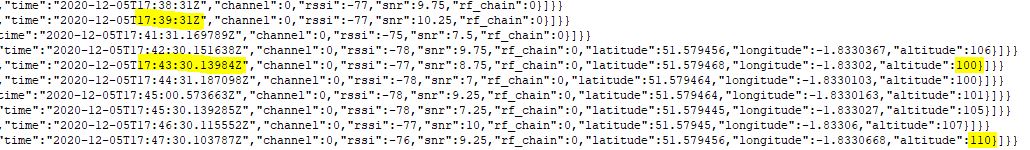

The MQTT data snapshot below shows the point before and after GPS enabled on the gateway.
It’s easy to see the extra decimal places on the “time” field, plus the insertion of latitude, longitude & altitude which was my original goal when incorporating the NEO-6M.
Ublox NEO-6M GPS
My altitude is bouncing up and down by maybe 10 metres from my reference height, but it can’t really be relied upon anyway because the GPS antenna is currently closer to the RPi than to the LoRa antenna!
