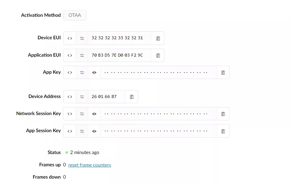

I have stm32 bluepill and lora module sx1276. I am using the guide made by: www.iotbyskovholm.dk/?Q=content/ibm-lmic-stm32cubemx. Unfortunately, the LoRa module is not transmitting, the program sends the “EV_TXSTART unkown event” message all the time. On thethingsnetwork, my node has an online status, but has not sent any package. Does anyone know what the problem is?

Please see the many times this is explained both in existing threads here and in the LMiC repository itself: your sketch is not up to date with the library version you are using, that particular advisory message is a non-issue but there could be other problems… Especially as it appears you might be using a sketch intended for the truly ancient IBM version of LMiC against the drastically further along MCCI LMiC library…
