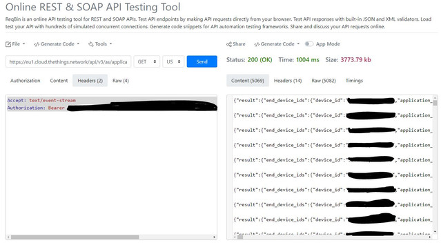

On this website https://reqbin.com/ you can try to make a call and see that data is returned. In other words, the STORAGE INTEGRATION API returns data on that website but our usual acquisition method has stopped receiving them.

In this website you can see that the data is returned from the Storage integration API but it is old data, that is to say, in our case they return data between:
2023-04-17T16:29:25.768
and the
2023-04-16T12:00:32.435890968Z
That is, the API itself has not returned data for 17 hours. It’s not our problem, it’s the Storage Integration API.
