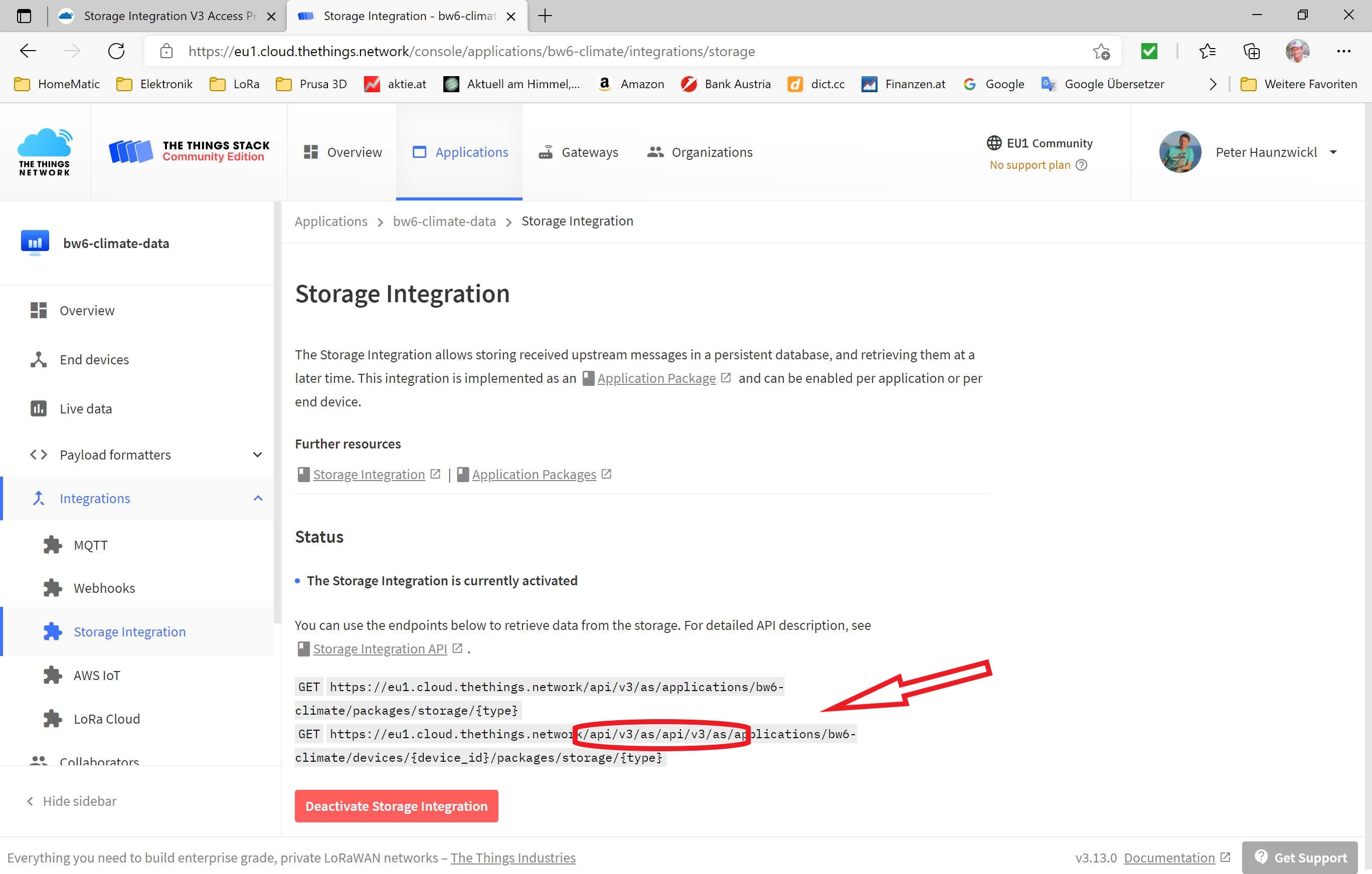

Please see the screen shot of the Storage Integration page. I remarked the “V3/as/” which is too much…
After correcting the string the call worked as expected :blush:.
This should be corrected on the console page. What is the correct way for an documentation issue?

Please open an issue on GitHub - but for the lorawan-stack not for the docs, the docs are correct and what’s appearing there is in the console.
According to the TTN software engeneer, the fix is merged and will be part of the 3.13.2 release.
