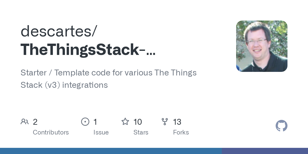

Please look at any of the other integrations like WebHooks or MQTT to get your data out. These may help:
