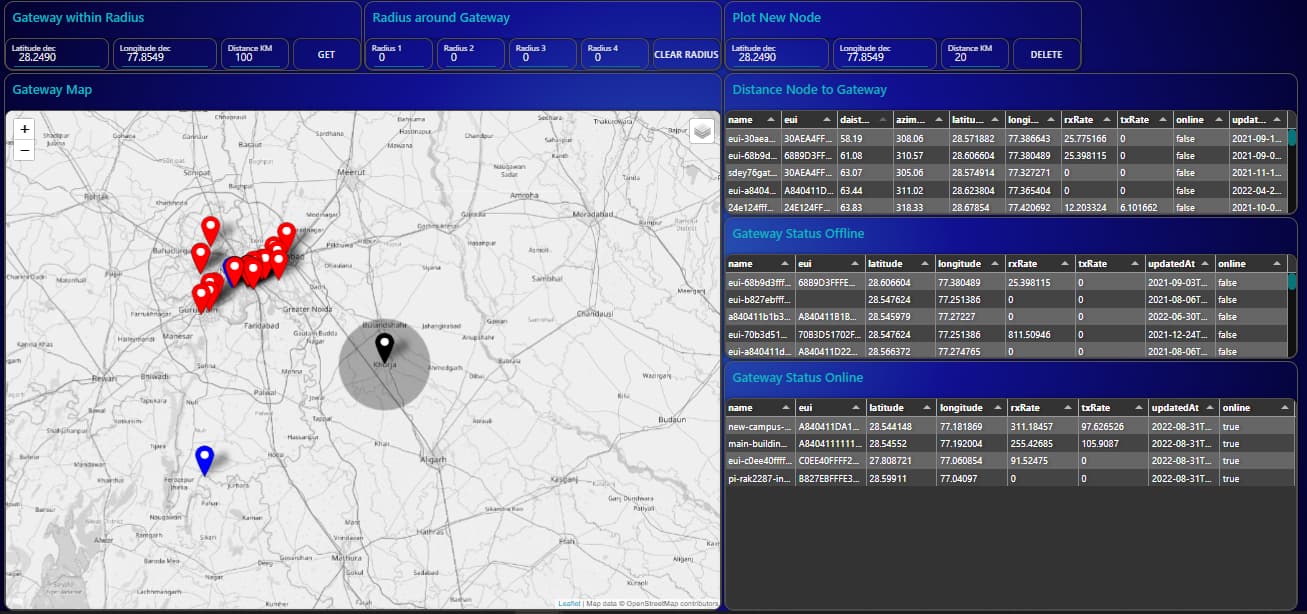

The circle represent a 20km radius, no public location published for any gateways.
So no community users are aware of a gateway available for use.

Gateway doesn’t have GPS so location is wrong in map.
