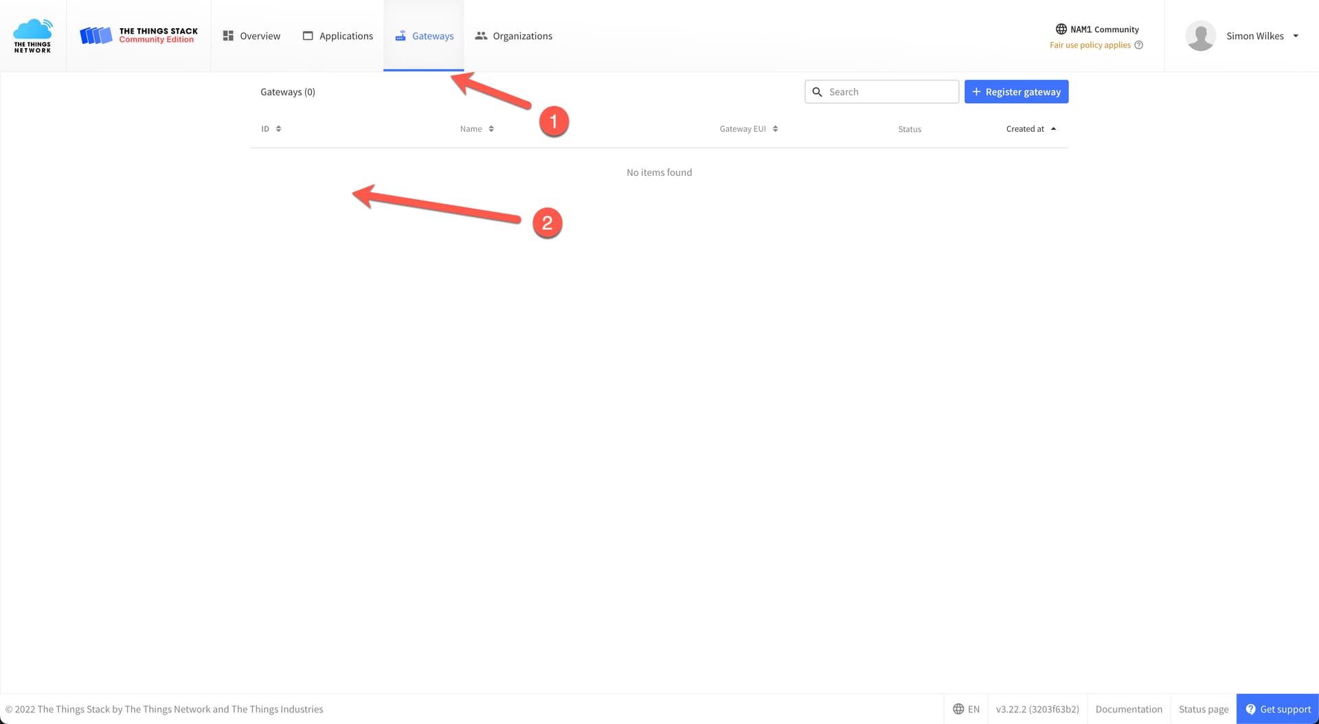

Please assist me in deleting my old account (including the account profile, applications, and end devices). The account is based in Europe. My new account is based in the United States.
There is no gateway registered on the old account, it has been removed. It was removed before the applications and end devices. As the old gateway has been deleted, the end devices cannot be utilized on the new account.

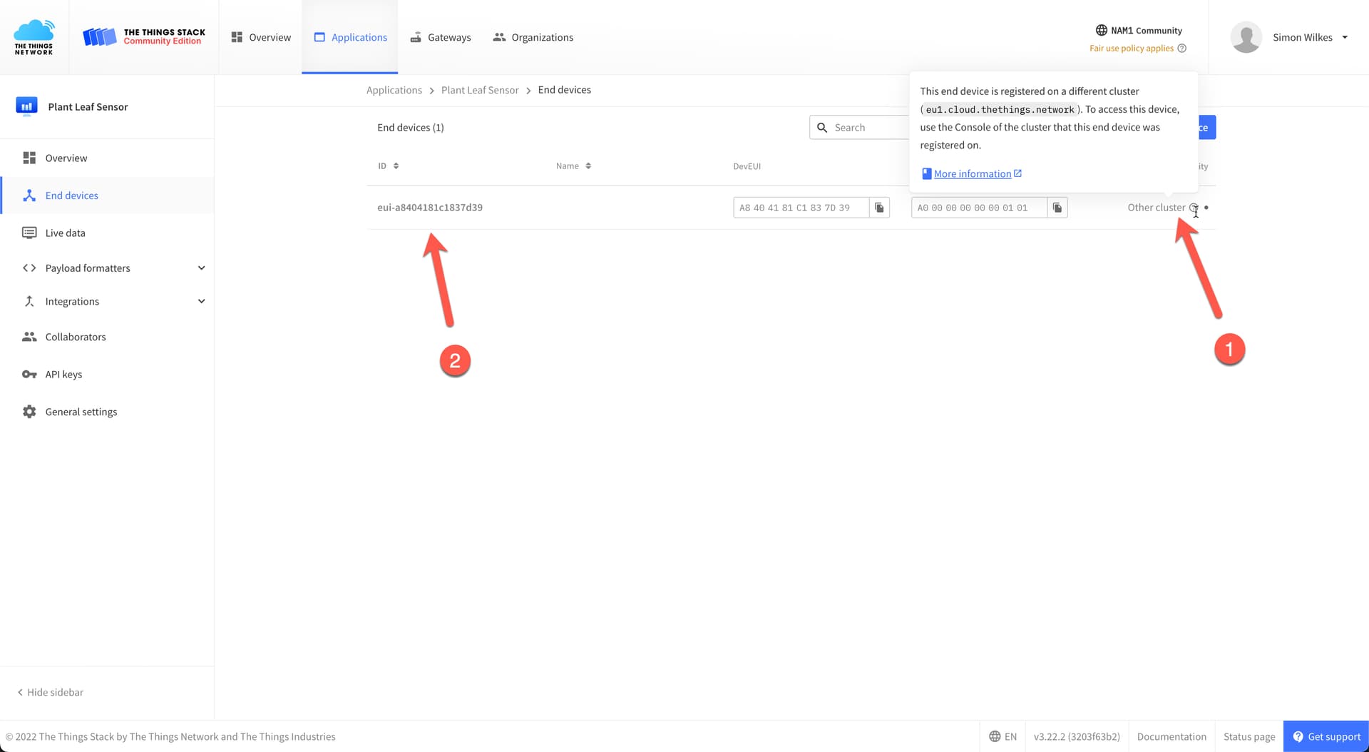

You can delete all devices and applications yourself. Just like the gateway.
Euh? Does not compute. Devices and gateways are separate entities in TTN. You just need to delete the devices. Go to the device general settings page and use the delete option to remove it. Do this for all devices and then use the same mechanism to delete the application.
Or use the command line tool achieve the same result.

Gateways are total separate entities and them existing or not has no bearing on applications and devices.
Looking at your screenshot you seem to try to delete the device while logged on to the us1 cluster, not the eu1 cluster. Go to console.thethingsnetwork.org and select the european cluster, log in with your old account and go to the application and your devices should be selectable.
@kersing you rock, m8! That was it. Thanks so much, m8! :pray: Have a good one!
