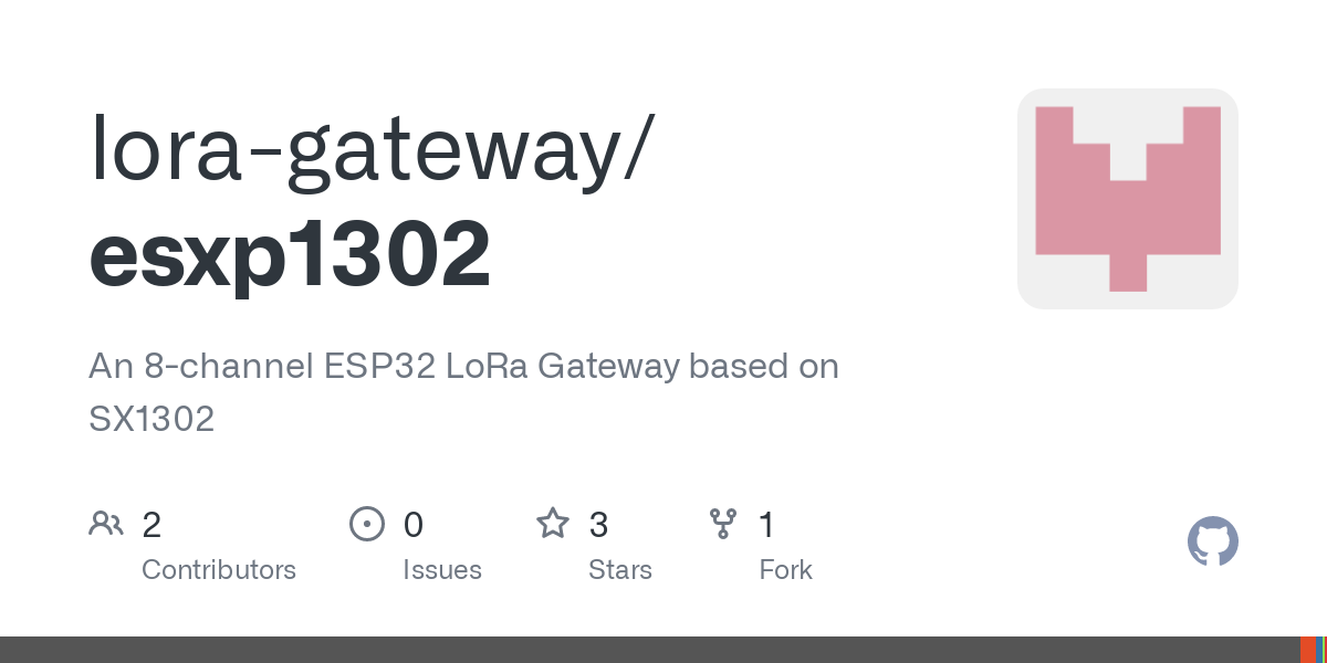

For anyone still dealing with this topic, look here:
I have found it miraculously using github search.
