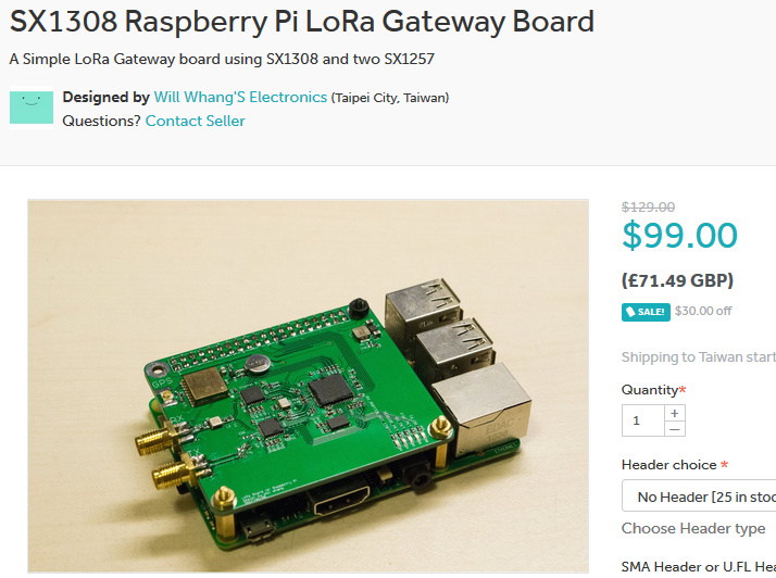

Does anyone have experience of working with this set up as alternate to usual Sx1301 based platforms?
Note no RF Switch so seperate RX & TX connections/ant’s needed

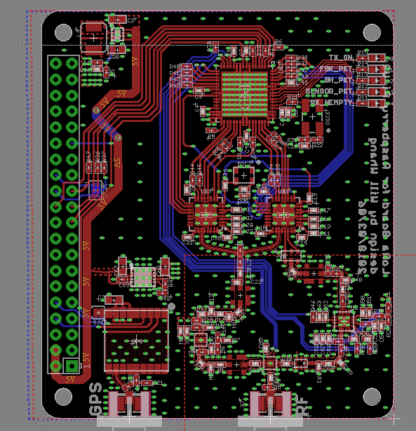

I have, since I am the developer
here you are!
but notice that I didn’t used TX
So it cannot downlink or OTA.
I want to specify that this board is mainly design for Receive only,
And there will be a much LoRawan capable board comming later

I was possibly misled on assumptions by the description on Tindie where it is described thus:
"TX/RX is not combined together with an RF switch, on the dark-side, it means that you will have to use two antenna for RX/TX or adding your own RX/TX switch, but on the bright-side, you can tune RF like adding more powerful PA or lower noise LNA+Filter near antenna. "
Was hoping to capture distant/marginal or fringe signals for uplink using high gain RX ant + poss LNA with then using a lower gain TX ant to stay withing RF TX Pwr(eff) Regs for closer in downlinks/acks.

If you want to add TX/RX switch, you can control TX/RX switch by adding GPIO control code in lgw_send(struct lgw_pkt_tx_s pkt_data) function
under ./libloragw/src/loragw_hal.c
Or put two antenna with some distance, but not using or weak PA, as long as the power doesn’t reach the limit of RX.
Then to enable TX, just change “tx_enable”: false, to “tx_enable”: true,
My personal setup is a bit like latter case, which is Big antenna for RX, and a tiny antenna for TX (well basically for OTAA)
