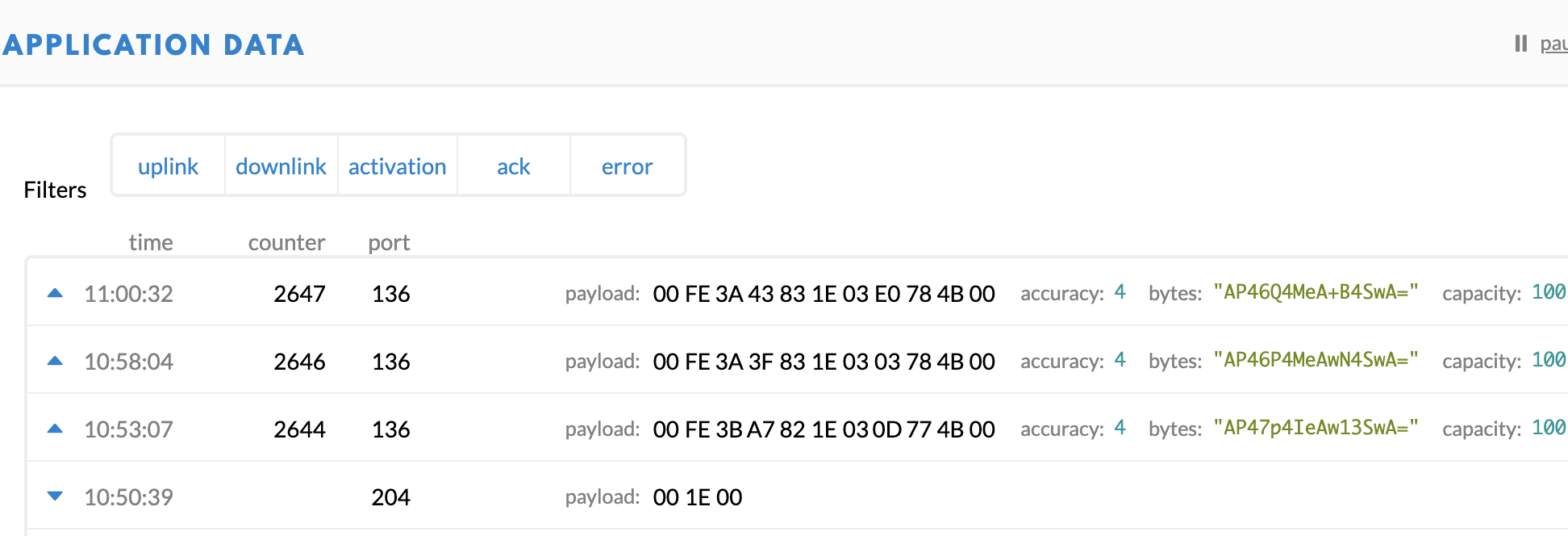

I try one to track a moving object, and while TBOL100 does what I expect it to do - start sending locations every 2 minutes, when moves - it does always send GNSS fix that has been 2-3-4 minutes ago. So while roundtrip time from the sensor via my own gateway, then through TTN to HTTP hook of my service, then to the app is 1-2 seconds, position reflected in the app is 2-4 minutes from the past.

Well, I did send 00 1E 00 on port 204, as described in manual, but it doesn’t seem to have any effect on the device.
Now it still sends every 2 minutes and 30 seconds.
I believe the commands have to be sent as confirmed downlink messages. I’ve seen a TBMS100 respond with a configuration settings uplink message each time a configuration command was sent. Do you also see that?
If it isn’t working for you, I think you should contact the manufacturer.
I tried with confirmed too, same effect. And yes I’ve written to BroWAN, no response yet…
