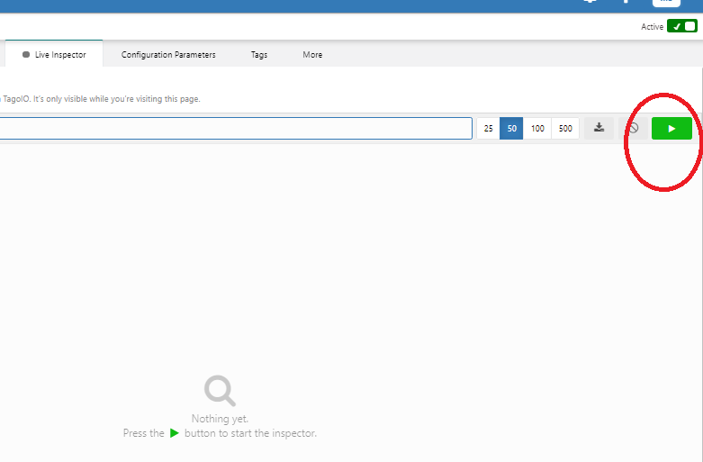

Strangely, while TheThingsStack CE continues to receive packets just fine, on Tago.io neither the devices’ bucket nor “Live Inspector” sees anything at all.

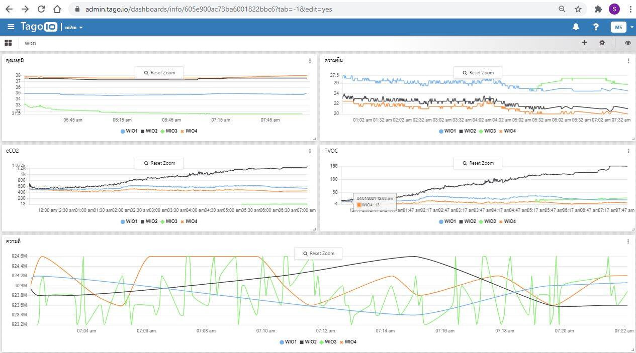

My friend are using it without any problem. Are you exceed 7,000 packet/hr quota?

Did you press green button behind?
