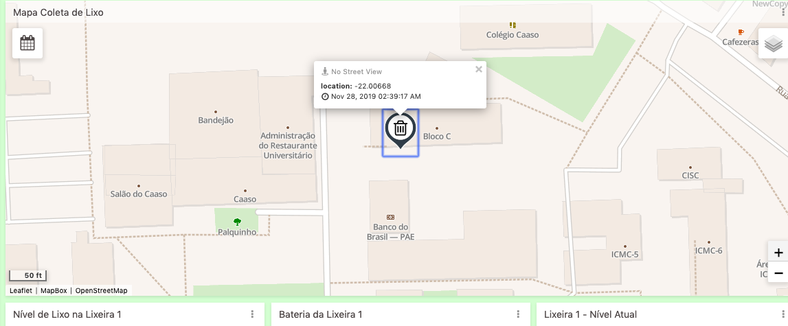

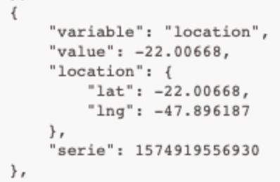

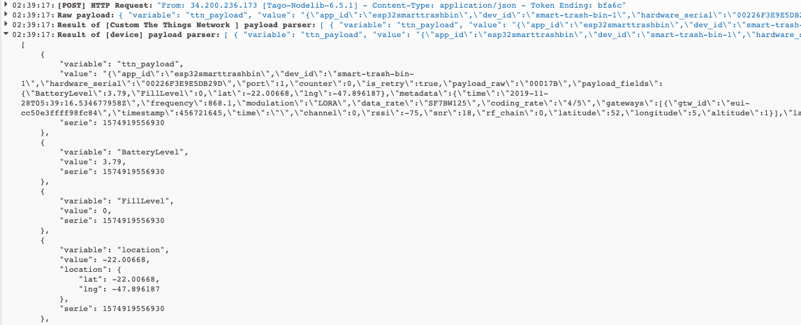

None of them worked (I have also tried other variations of decoder functions, with no success). When using the Live Inspector on Tago, I always see something like that:
In some situations, TagoIO creates a variable called “location_location”, with the location field required. But the “value” field is always equal to the “latitude” variable, so I can only see this on dashboard map, as follows:
That means I’m either sending the data on a wrong format, or parsing the data wrongly on TagoIO (I couldn’t understand the parsing function correctly).
