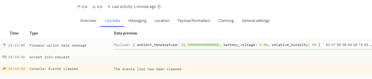

Problem solved.
Error in the AppKey. Device was already removed from V2 but luckily I found the original keys on my server.
AppKey is indeed programmed into device.
Thank you for the support
