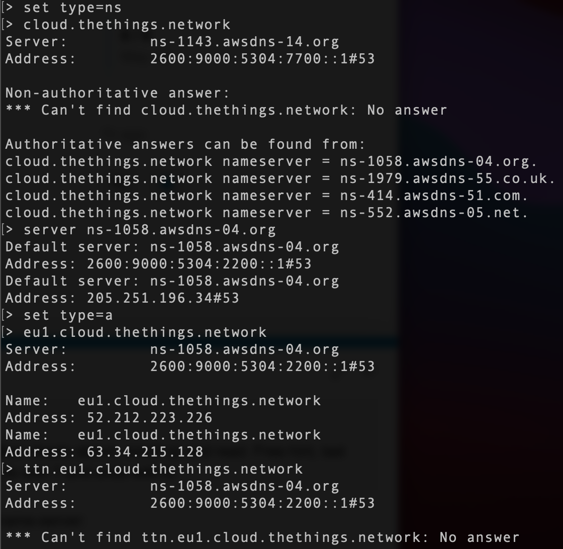

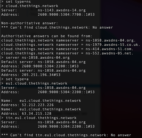

That adres is not registered at the name-server at a authoritative nameserver of cloud.thethings.network:
Output of nslookup (especially last 4 lines)
I guess AWS also cannot contact the service/API at The Things Stack.

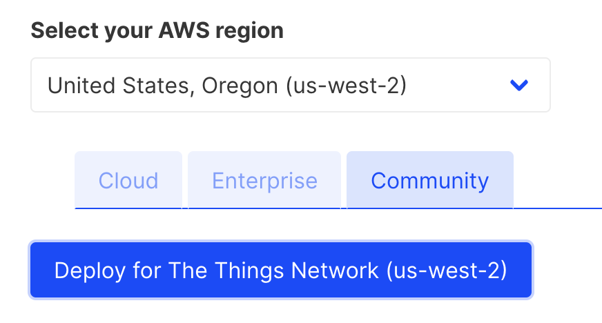

To help clarify, if you are using the Community Edition, be sure to select that (and not the Cloud or Enterprise option) and also choose the correct AWS region before clicking the big blue Deploy button. When you take this route, the cluster address is just a drop-down menu, rather than a string that you have to fill in manually.
It may not be obvious that “Cloud,” “Enterprise,” and “Community” are actually selection buttons that will change the rest of the screen and the deployment options. Selecting the AWS region is a little more obvious, but be sure you set both of them correctly.

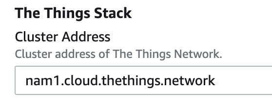

Once in AWS, the Cluster address is a drop-down menu, not a text field:
