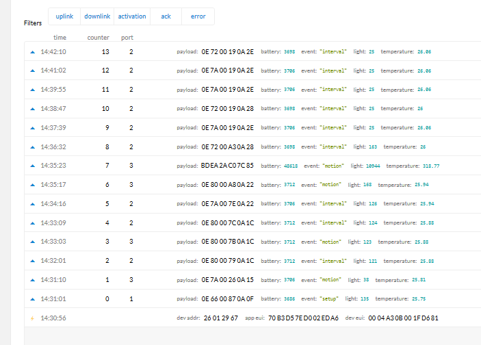

b) Assuming that the attacker has needed key (inputted directly into code), I have been able to send one packet (step 2). It is the packet with counter = 7 in the attached screenshot. But unfortunately, I was not able to send a packet from step 3.
I have tested the MAX_FCNT_GAP with many values { 400, 16384, 65536}. In each case, I didn’t see the packet with provided FCntUp. Additionally, I have also tested this vector where step 3 is replaced with duplicated step 2 - still no luck.
In both steps, I was using the same JSON from the captured packet (step 1) - I only put an incremented ID of the IP packet. To your knowledge, in the aforementioned case what field the TTN NS is using to determine that incoming data is not valid? Am I missing something important which doesn’t allow me to send the packet from step 3?
