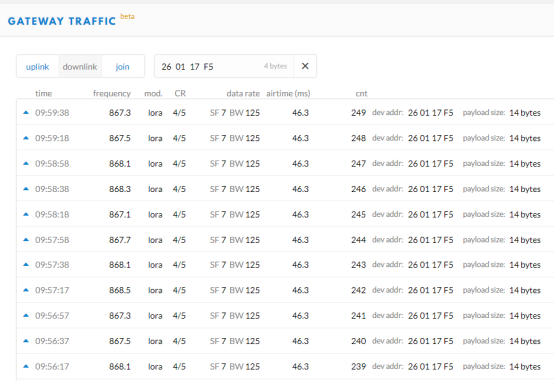

Why does the gateway have data transmission, but the device does not receive the data?
The gateway received three frames of data at 09:58, but the device’s application data was not received.
First I assume that you are performing a test (cause the TX rate seems high). I suppose your issue is the same discussed in the following topics:
Seems like that the MQTT API have some issue infact many frame get dropped. If you try to enable to Data Storage Integration you will see that data get successfully received by TTN and stored, you could fetch data from there, even if this is not a real solution.
