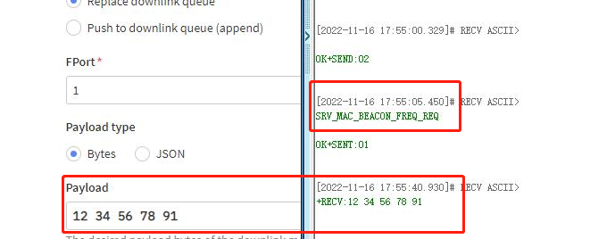

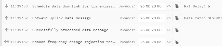

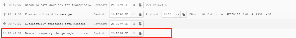

When I use Class A, I send a message to the gateway. The gateway sends a BeaconFreqReq request.
Device Debugging Information:
SRV_MAC_BEACON_FREQ_REQ
MOTE_MAC_BEACON_FREQ_ANS

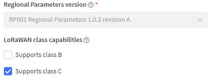

Is your device correctly configured in the console? You didn’t accidentally check the class B checkbox?
Those to options should not be selected if your node is class A

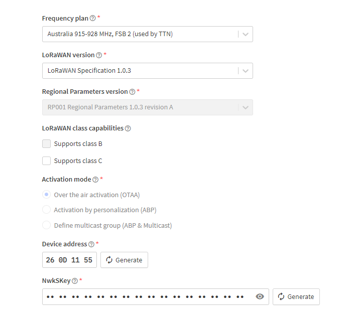

In fact, I canceled both CLASS B and CLASS C, but it’s still BeaconFreqReq request from the console. I found the record of August, but there was no such request.I don’t know if it’s this, but I feel like my End-Device is not working properly.
This is the configuration in my console. I’m canceling CLASS B and CLASS C, and in fact, the node will receive SRV_MAC_BEACON_FREQ_REQ when it sends.

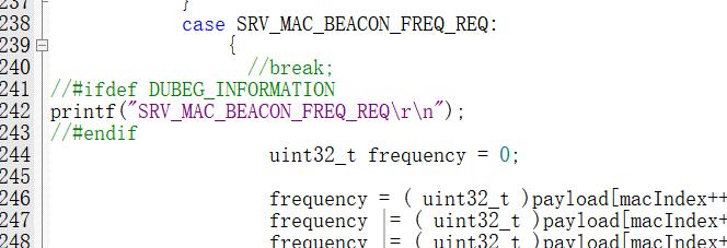

Once you’ve mastered scrolling up & down source code at speed, you’ll be able to automagically spot these things.
It’s LoRaMac-node and it’s the last case statement in ProcessMacCommands - I’d be tempted to suggest that some re-arrangement of the brackets has occurred and it is being tripped by mistake.
True but that is a challenge with the posting of images vs formatted </> code!
Even a statement to say ‘its LoRaMAC-node’ (version?) would help point volunteers in right direction unless - like some who have read in detail and swallowed whole & applied near photo memory!
- know well and in detail.

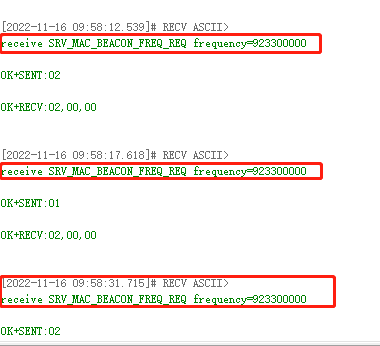

But once it has its power cycled, it will definitely connect via OTABP to the gateway …
Yes, this is the statement in ProcessMacCommand. All I did was add a printed message.
Even if I lose power for a few minutes, I need to re-use OTAA to join the gateway. The effect is the same. I’m not an expert on this, but I saw from LoRaWAN 1.0.3 that this statement belongs to Class B and is sent by the gateway to the node. So I’m confused.
