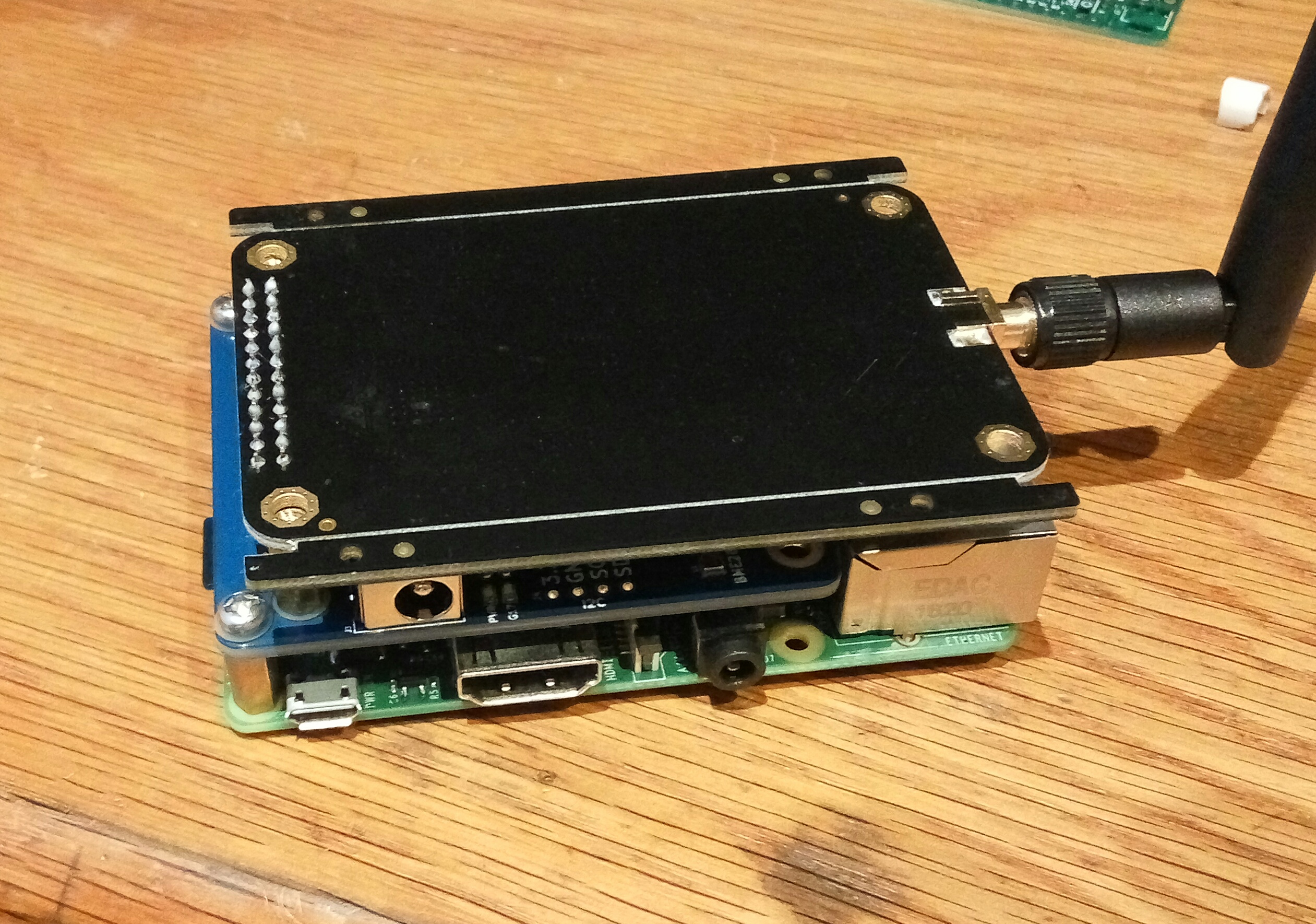

My PCBs arrived
Tested and working…

Does this mean you are the first to have a working interface PCB for the RAK831 + Pi (well in Europe at least)?
Do you intend to sell these as I have a RAK board somewhere between Asia and Ireland as I type…
Looks neat, good work.

I’m not the first to have a PCB, Kilobyte had boards days ago, but as I got a RAK831 early on I’m one of the first with a tested board.
I have a limited number of boards available for sale @ 4.50 euro plus postage (just PCB, no connectors).
Later this week I will put the design files somewhere public so anyone can download them and order their own board(s) at a PCB house. (Cheap PCBs == a couple of weeks wait time, faster == more expensive)

Looks very interesting/ Are you publish sch/brd files ?
