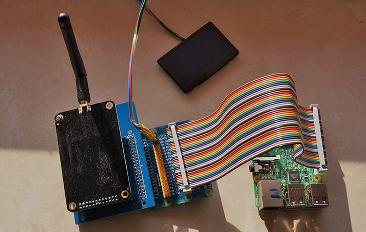

After coffee I’ll boot my ironstation …
finding a (temp) way to having access to the RPI GPIO with GW connected

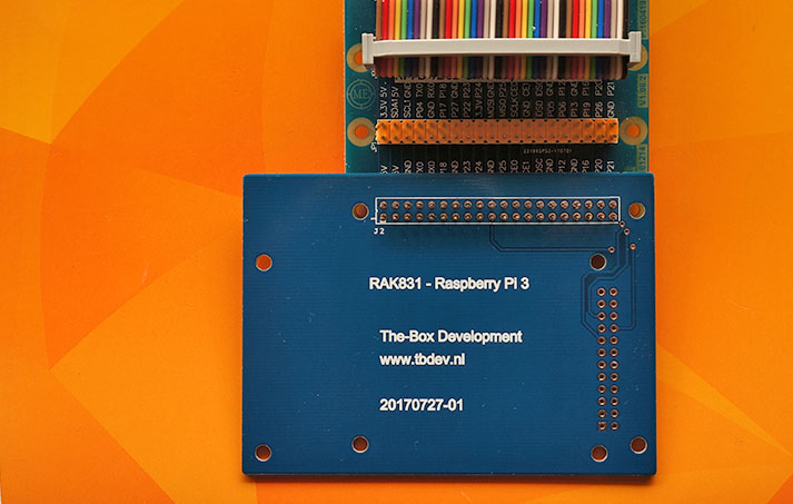

:hushed: clever … why the SMA connector on the converter board ?
For an optional GPS antenna, there’s a module footprint (SIM28M?) next to it
yep, that must be it
