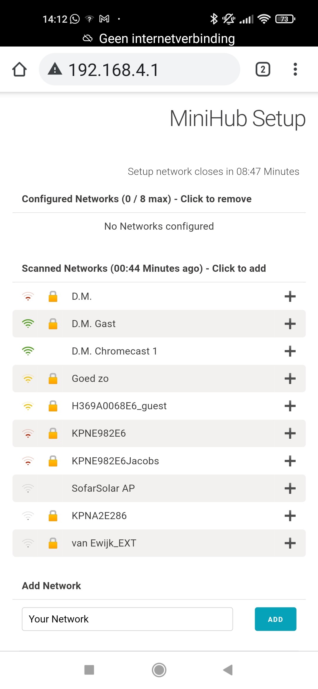

Only the webui from gateway let me see only very bad wifi signals…
Untill the gw NEAR the router is.
I try other wep code.
Never is the gateway connected with my wifi/internet.
Is there a other way to update to v3? perhaps with usb-c?
Or what could be a problem in the connect with home wifi?!
Screenshot_2021-07-29-14-12-18-169_com.android.chrome
I need the D.M. only D.M. gast is green. All the thers in the neigbour are also yellow???

This looks just like a problem with your WiFi, I think you should fix that first.
Maybe you can configure something about it in the router, for example put it on a different channel, but I really don’t want to debug stuff like that.

Try other channels
