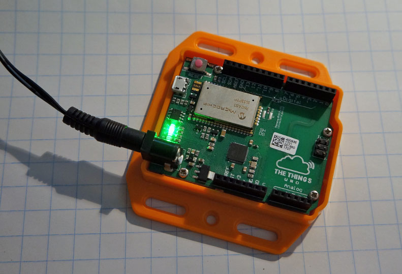

I am trying to power up my Things Unos via an AC/DC wall adapter with barrel jack connector but to no avail. I was looking for instructions specific for the Things Uno but couldn’t find any, so I followed the specs for Arduino Uno/Leonardo instead.
I’m using a 9V, centre positive switching power adapter, bought a few of them and checked that I am actually getting 9V out of them and in the correct polarity, but none of my Things Unos turn on. They work fine plugged in via USB either to computer or a USB mains adapter.
What could be the issue?
Thanks!
strange… I tested it just now and it works.
