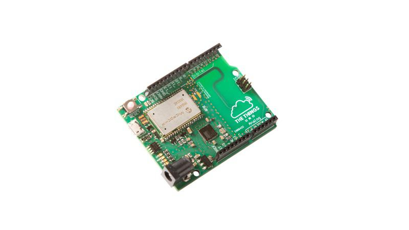

I recently purchased TTN UNO and right out of the box the device couldn’t be seen on the activation map. I ignored this and carried on with the quick setup. During the setup process I was able to get the device to communicate with the application on TTN. However, since then I cannot get it to join via OTAA, all i get is Join not accepted: denied. I deleted the app and registered the device but still cannot connect! If there is any information that could help it would be greatly appreciated.

I have a similar question as ross_s. I purchased a Things Uno from Element4 (915 MHz unit) in the US. When I try to activate it I am unable to see it on the map.

I am trying to power up my Things Unos via an AC/DC wall adapter with barrel jack connector but to no avail. I was looking for instructions specific for the Things Uno but couldn’t find any, so I followed the specs for Arduino Uno/Leonardo instead.
I’m using a 9V, centre positive switching power adapter, bought a few of them and checked that I am actually getting 9V out of them and in the correct polarity, but none of my Things Unos turn on. They work fine plugged in via USB either to computer or a USB mains adapter.
What could be the issue?

I recently purchased a TTN indoor gateway, a TTN outdoor gateway, 2 TTN NODE’s and 2 TTN UNO’s.
after a bit of a learning curve I have both gateways working and both TTN NODE’s are reporting. Both NODE’s worked out of the box to TTN mapping, and then worked fine when I changed the sketch to what I needed.
But neither of the TTN UNO’s even show up on my windows 10 computer. I have tried 2 different laptops and desktops, different cables; and still the same issue. Error 43 on windows USB device. I do have it set to Arduino Leonardo board and the TTN libraries loaded. I’ve tried uninstalling the usb driver and re-installing. I can connect with same cables to the NODE units, but not the UNO units. I even tried 2 different brands of ICSP USB cables instead of the normal micro-usb cable.
Thanks in advance for all hints, directions… jedi tricks are welcome. I’m stumped.
I already had ‘verbose output during upload’ checked. I can’t even get to upload sketch as the UNO board does not show up as valid usb serial port.
I checked the library and i currently have The Things Network Arduino Library version 2.5.16 installed.
So that doesn’t seem to be the issue. When i reboot Arduino IDE and remove USB cable and insert again i get windows msg ‘setting up Arduino Leonardo’, then msg of ‘unrecognized usb device’, this usb device malfunctioned.
I plug in either of the new NODE units with same cable and they are fine. I plug in either of the new UNO units and this same error. Could I possibly have gotten 2 bad boards?
