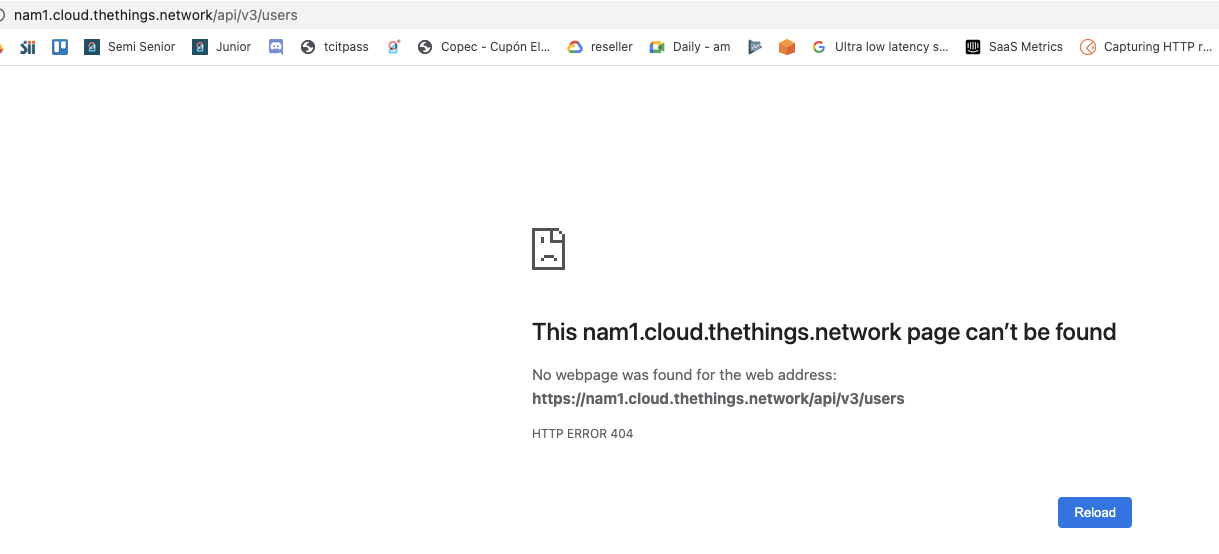

I should be able to query: https://nam1.cloud.thethings.network/api/v3/users/
But It returns a 404

Yup, same thing without trailing /

Was this ever resolved? I’m also getting 404 errors while making requests to https://nam1.cloud.thethings.network
Was this ever escalated? To answer @descartes I get the same behavior with or without the trailing slash.
I believe it’s all held in the one Identity Server which is on the EU1 domain.
@descartes is correct. All calls to the Identity Server must go to eu1.cloud.thethings.network.
