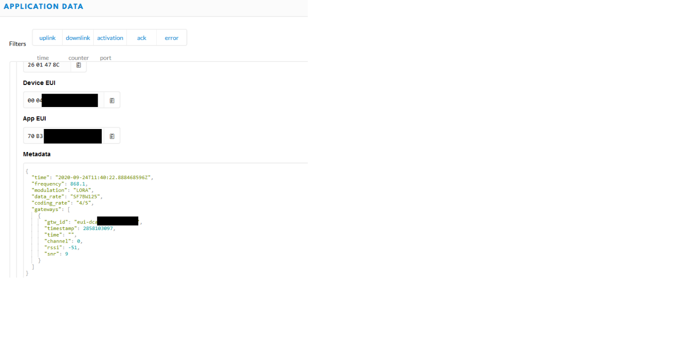

I took the Basic configuration in the Arduino IDE for the Node configuration and I still get in the console:
Sending: mac join otaa
Response is not OK: no_free_ch
Send join command failed
My questions are as follows:

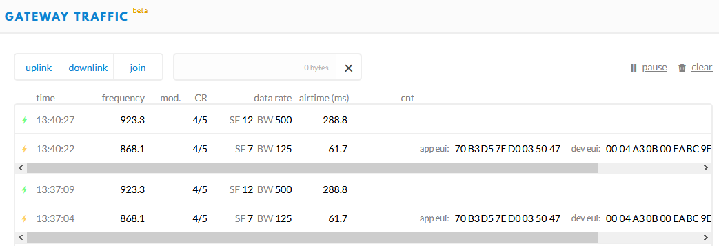

- Why do I have 2 different frequencies in the console gateway traffic (923.3MHz SF12 & 868.1MHz SF7)?

- Is it normal that I don’t have a “time” for the Node’s Data application?
