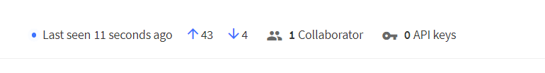

Hi, I recently registered my gateway (Dragino LG01N) and sensor (LDDS75) into the V3. However, I found that when the gateway console is receiving uplinks from my sensor, it does not perform downlinks to the application console. I’m using ABP mode.
Please let me know what is my problem?
