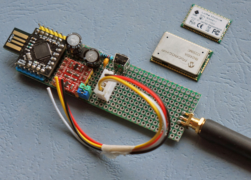

my first RAK LoRa module arrived … very curious to compare it with the RN2483

which LoRa module to use for the BRZ TTN stick ? maybe a future PCB that accepts both ?
probably eth0maz could create one?
I’m sure he can

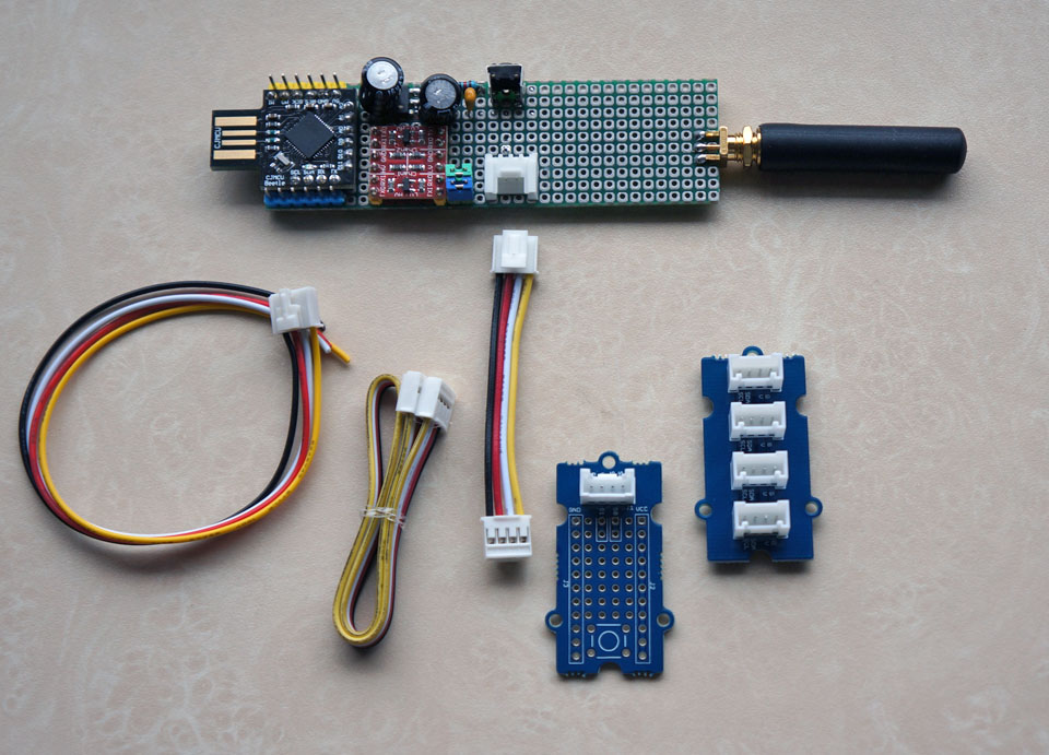

, but I’m not finished… it’s half of my idea, the other half is a backplate with LION battery / charger/ I2C Grove hub /dcdc converter.
So you can use the stick in your PC and connect a grove sensor to write code and If you slide it in the backplane, it can operate on rechargeable battery power, so it has dual functionality.
lesson learnt, a GROVE connector is not the same as a JST

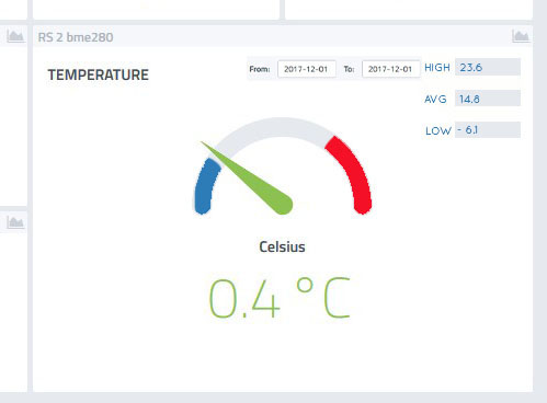

cayenne temp widget suggestion
What are the Settings of your Temperature widget?
It is not a standard “Gauge” widget, is it?
Cayenne asked for ideas … I thought this was a nice enhancement for the basic ‘gauge’
Maybe even setting trigger or visualize triggers that way
If Cayenne takes care of the HIGH/AVG/LOW it saves some node energy
I see. It is an improvement idea.
date+time of the last data update on all widgets would be very useful.
they really would like to hear from users what they want
If you do make an average then maybe an automatic 30 day average for example.

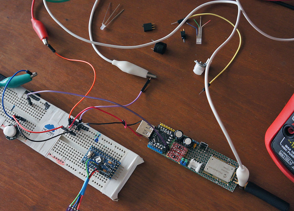

testing external interrupts ’ TTN’ stick here with a little PIR
encountered a problem using the beetle 32U4, not all available pins are suited for external interrupts.
Solution that seems to work = the Enableinterupt library
