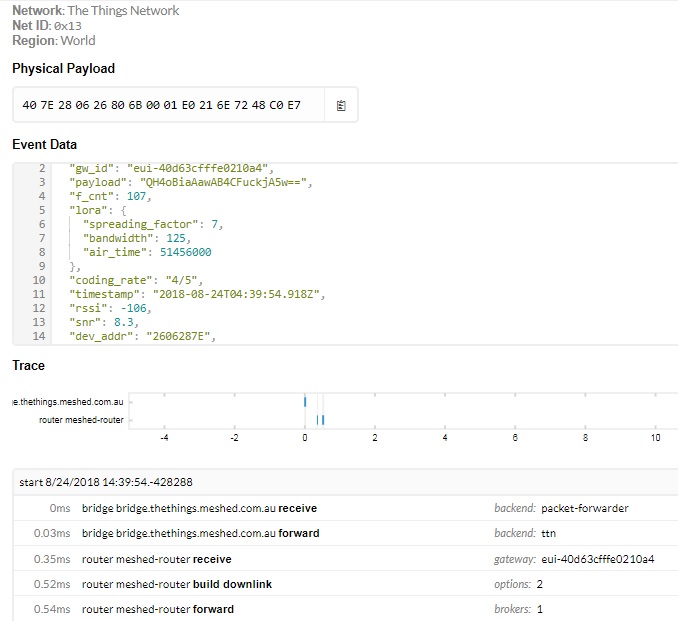

The traffic from this device and App is always seen on our Gateway as shown on the TTN Console, Gateway, Traffic page.
But the traffic is only seen for between 30 and 100 Counts then nothing for hours in the APP section on the Console.

edit: route info from gateway.
GWmissingTrafficRoute
Our old mate FCnt got me.
Each time i reset or powercycled the node the Traffic would be rejected until the up count was above the last highest count.
