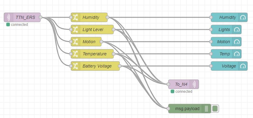

The way i have chosen for now is to use Node-RED software installed on my server, again if anyone knows another way without using Node-RED then i would like to know.
Below is the Node-RED flow

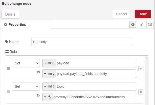

The MQTT in from TheThingsNetwork is configured using the following, make sure you set it to a parsed JSON object as the payload is a string/JSON. Once changed the data is now a actual JS object (not a string / not JSON). Steve_Mcl helped me with this solution on the Node-RED forum.
Now its an object, you can simply “copy path” of any item in the object & use that in a change node block, below is one off the change node blocks.
