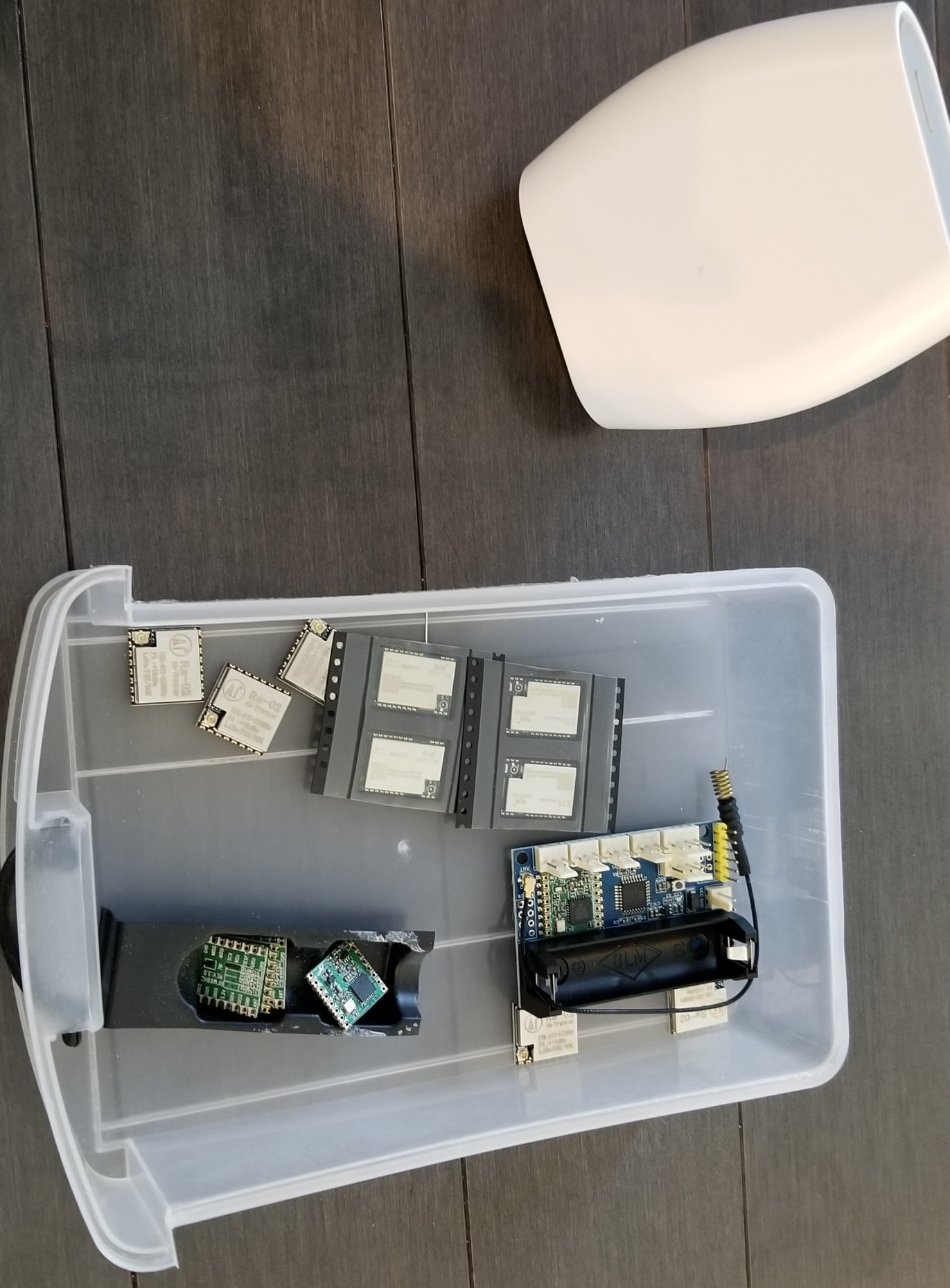

I’m sharing what i have for developing lora node, please let me know if i can develop some node with this module i should buy some other cheap node to ensure if my gateway is working good, please refer to image. (there is arduino based module and gateway)

I assume your phone doesn’t allow you to crop pictures?
You’ve got some RFM & RA-02 modules, the second is 433MHz and I can’t tell what model of RFM you have so don’t know if they are on-frequency. But you did say you had some RFM69’s, so if those are that, they don’t use LoRa.
The ones in the blister packs I can’t see what they are as the text is too blurred but may be Ebyte.
As for the MCU, you have an ATmega328+RFM95 based module which mostly seem to come as 433MHz.
Perhaps you could help us to help you by WRITING DOWN what these modules are, look at both sides so we can be clear about the frequency they are made for.

One with ATmega chip on it has RFM95 (915MHz) module installed
EByte modules are E-78 & E22 (on product page it says that they support 915MHz)
and also have some RFM95 modules
