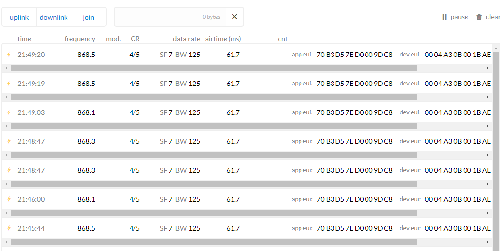

The TTN console now shows the join request, but the join is not successful as before…2018-02-20 21_50_21-The Things Network Console
2018-02-20 21_51_24-The Things Network Console
Is there anything else I could check?
Could this be a hardware related issue, like the antenna is broken or smth. like that?

…but it should also show a Join Accept response if the keys were accepted and the same gateway was selected to transmit that (or some error if all gateway(s) are busy). And the device’s Data page should show the activation too, if the keys were accepted.
I doubt that would be affected by the earlier network problems. But maybe it is.
Orange/yellow uplink for a Join Request, and a green downlink for its Join Response:
(August 2017 screenshots.)
the thing I see from his screenshot is no join response and a very short interval
Nice catch, that’s a short interval indeed: it’s not even waiting for the 5 seconds RX1 in some cases.
which is strange for a TTN uno with RN2483 … it would never allow that (I think :smirk: )
Also, when joining too often, the chances of repeated (invalid) nonces increase too. (Though that would also show an error: OTAA shows "Activation DevNonce not valid: already used")
Is the node somehow resetting all the time? Is its power okay?
Is there anything in the “trace” part of the Join Requests in TTN Console?

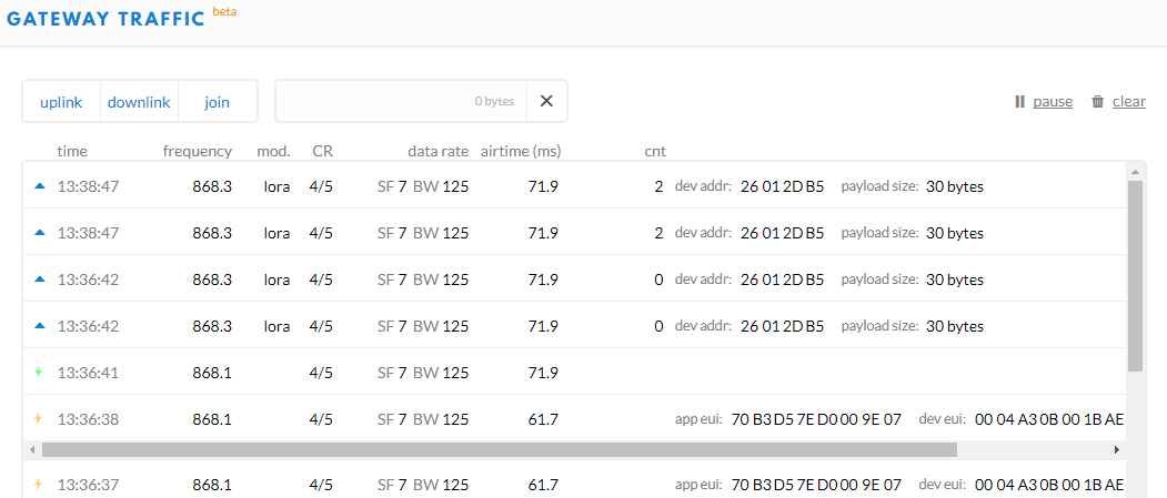

Ok, after removing the device from my app, and re-adding it, with the new AppKey, everything works fine. Don’t really know, what made the UNO run mad, but now it looks quite normal.
2018-02-21 13_39_39-The Things Network Console

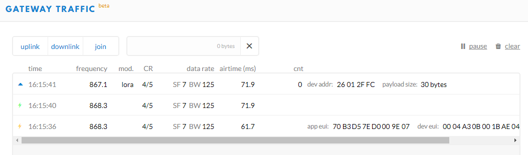

not to me… 2x same packets @ the same time and skipping one frame
  • ok skipping can be collusion… better to look at application/device console

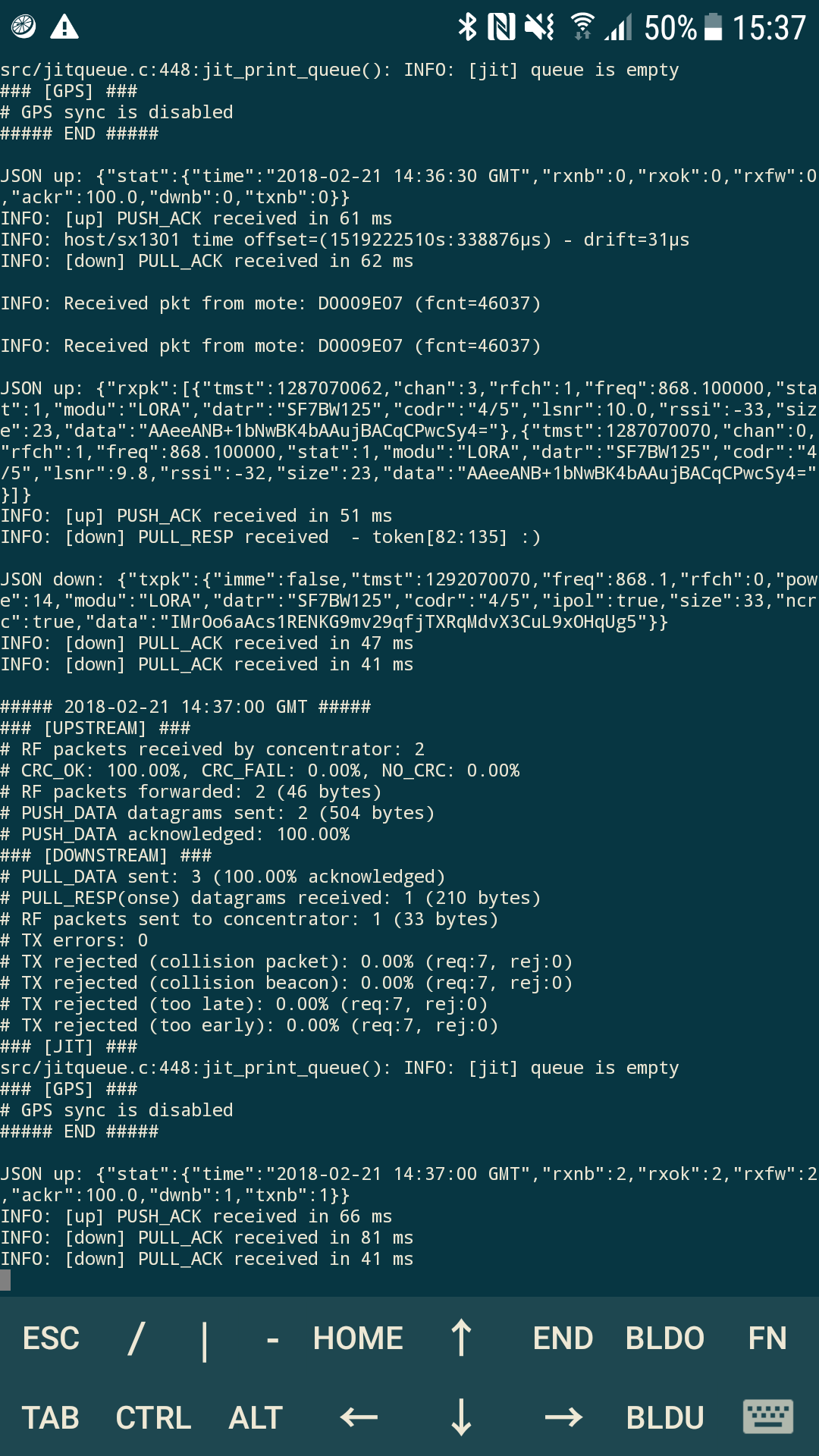

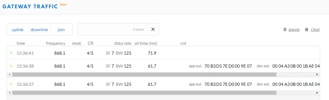

You are right BoRRoZ, I had to restart the Gateway. Now the Msg is received just once :slight_smile:
2018-02-21 15_37_32-The Things Network Console
compared to the gateway.log
Screenshot_20180221-153719
But SerialConsole showed only one transmission:
