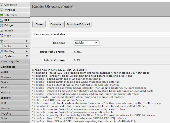

It seems i was wrong, please see:
One of the gateways was running the following(this was the GW giving the issues):
and the other one which was working fine was the following:
Do I just download and install the latest version for both?

Thank you for your feedback. I have downloaded and installed the latest firmware version for all the gateways. I have rebooted the and will keep an eye out for the downlink message failures and keep you posted if it occurs again.

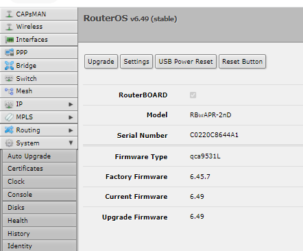

Please make sure to go to ‘System’ - ‘Routerboard’ and run upgrade there as well if you didn’t do so already.
Thank you, I have just completed the firmware upgrade aswell.
I suppose now i just continue monitoring the gateway packets to see if the downlinks are sending succesfully?
This resolution seemed to fix the issue, the gateways are working as required and downlinks are being sent through succesfully.
