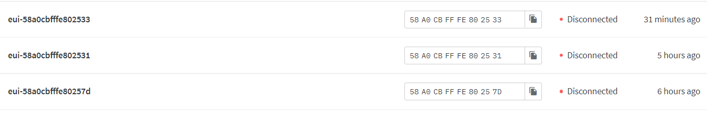

Yes, I’ve tried with three different Gateways at this point all with the same results. Here are the DevEUIs:
58A0CBFFFE80257D
58A0CBFFFE802531
58A0CBFFFE802533
Can you show the GW outline console page…

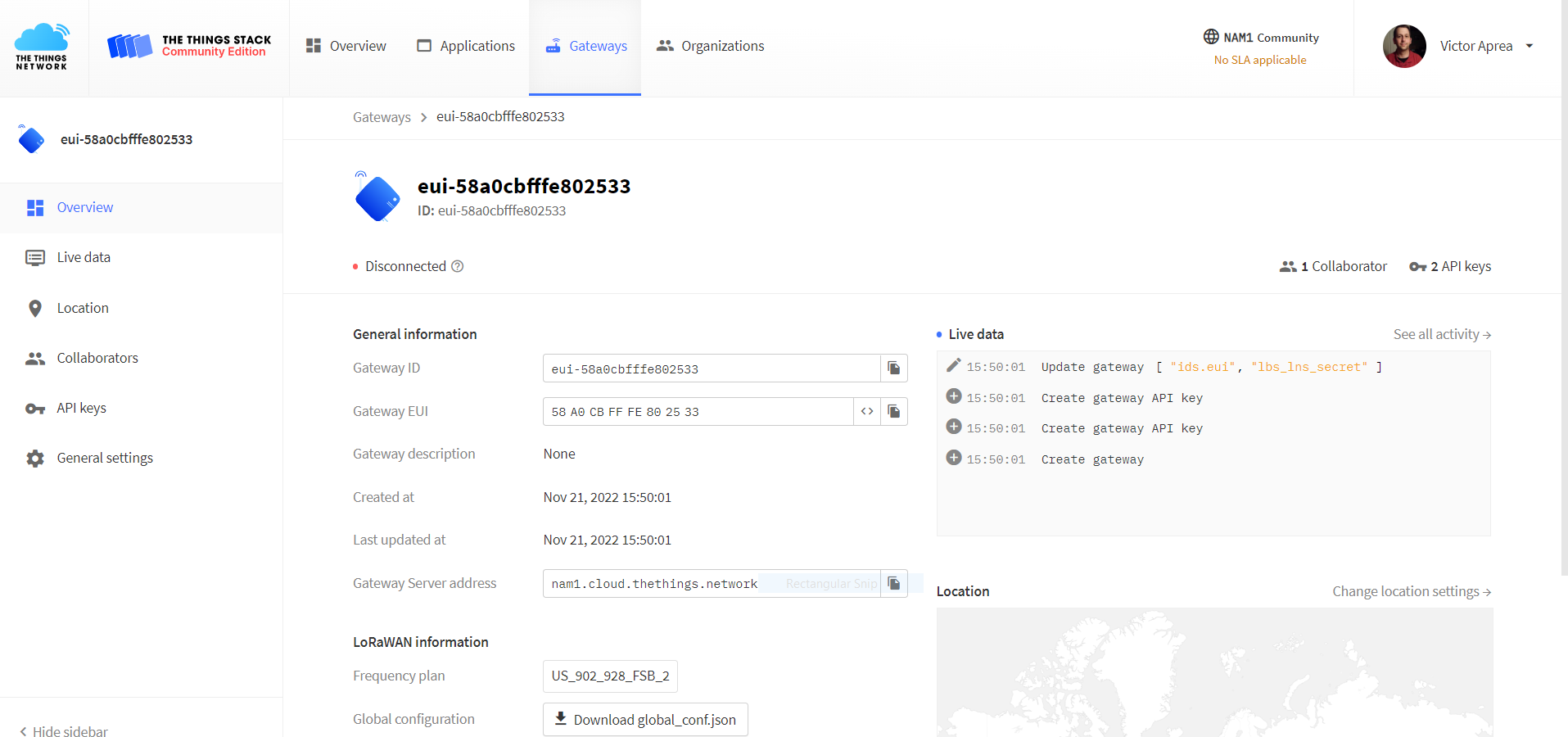

Jeff, I had no trouble claiming them using the DEVEUI plus the WI-Fi password, that all worked fine from what I could tell. Here’s a snapshot of the overview page for one of the units:
I don’t see any evidence that the unit has made any form of contact with TTN, consistent with the notion that it can’t establish a connection with the LNS.

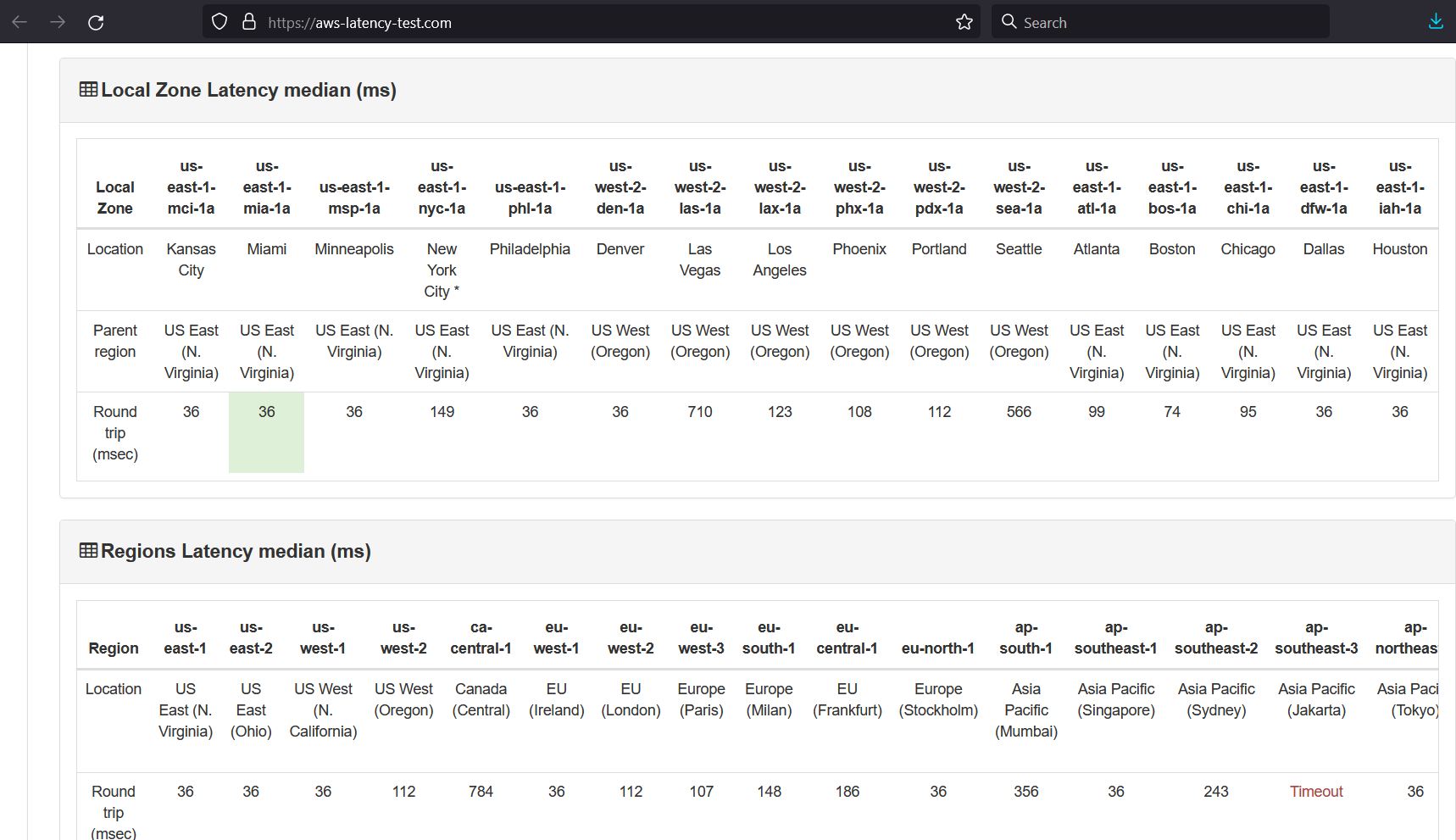

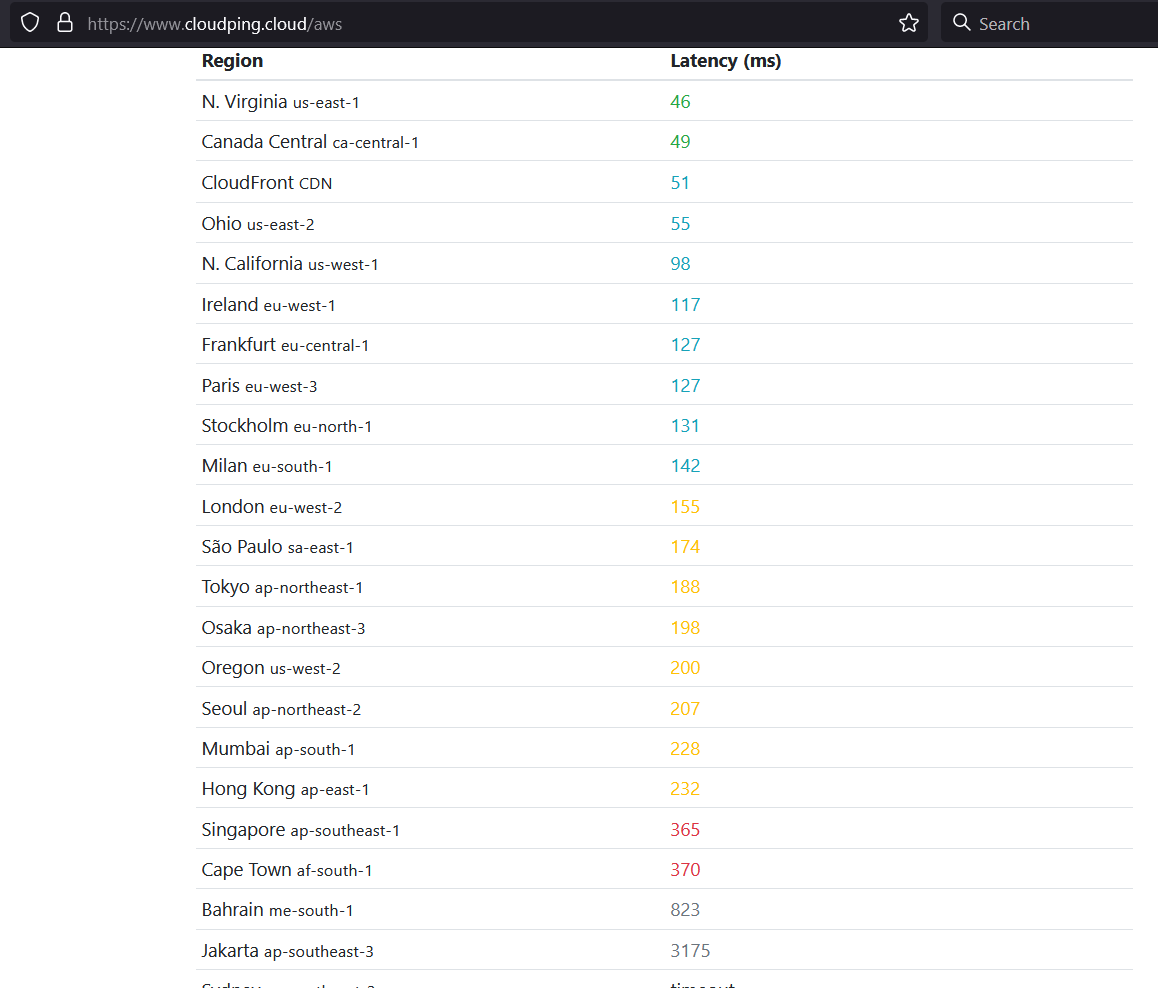

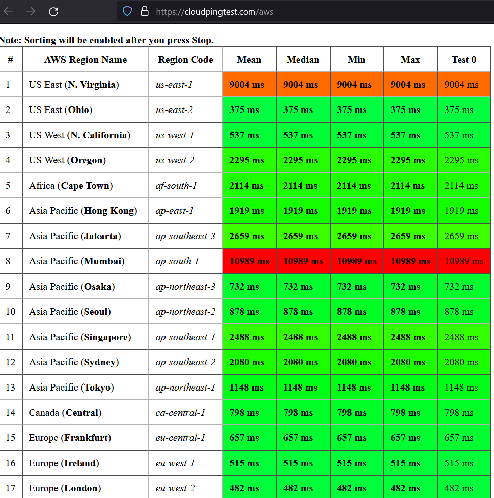

Here are the test results from the network:
cloudping.cloud
cloudpingtest
aws-latency
